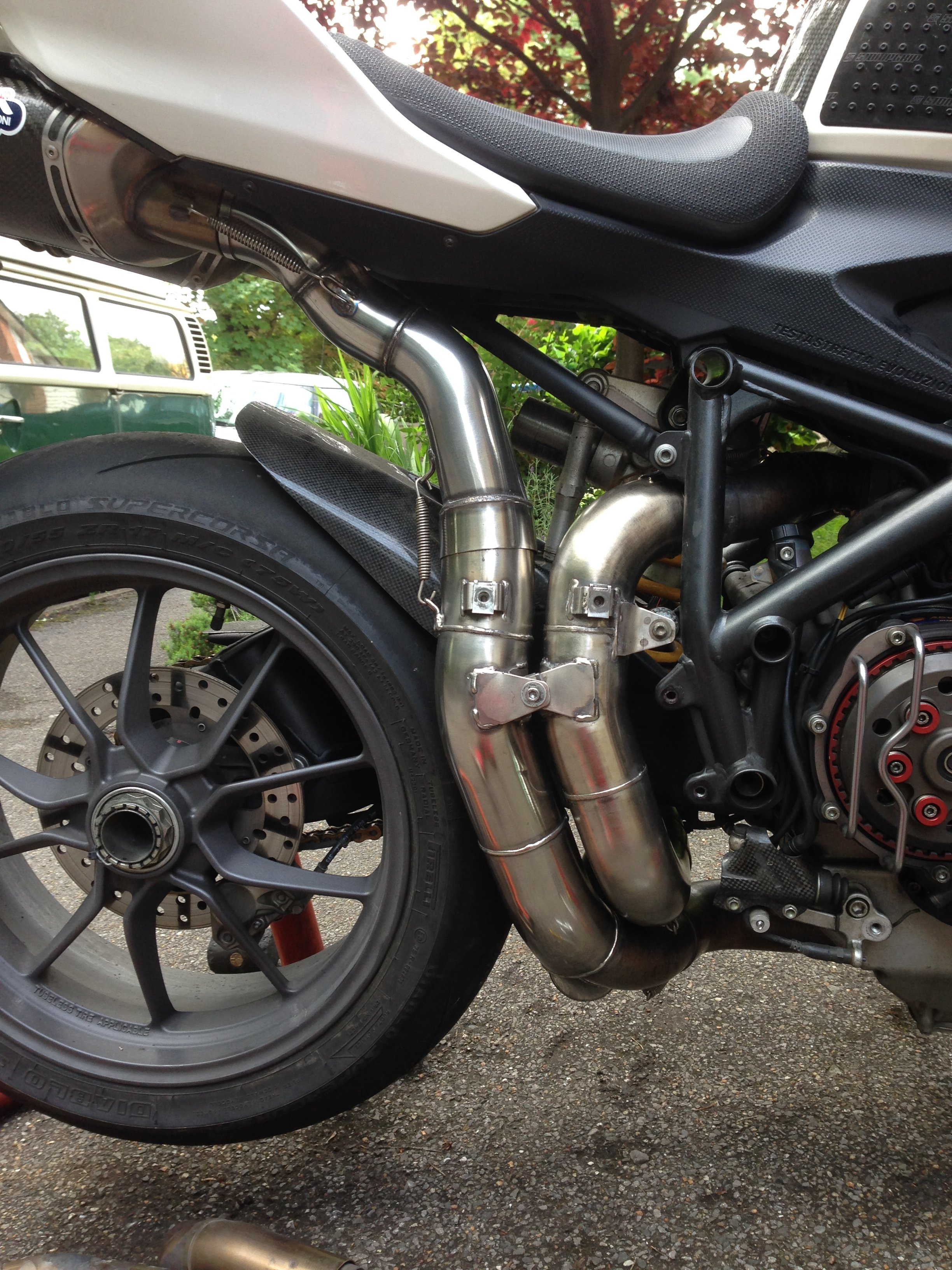

  1. I will be fitting these at the weekend. Apart from new gaskets and copper nuts, is there anything else I should look out for or that i will require in order to fit them? I have the full dp ecu already thanks to chrisw. And i will be off to CJS as soon as ive paid the pipes off my visa.
    Any advice greatly welcomed.
  2. I've just had mine fitted, and they had to use spacers on the RH rear set (look like standard washers to me) not very thick. And if you had a "full" hugger that won't fit any more unless you modify it I guess. Is your long pipe from the front cylinder to the rear of the bike flattened on one side to give more space between the fairing and the pipe? I believe the older ones were still completely round so you may need some heat shield for the fairing. Thats about it I think.

  6. I chanced upon them on eBay as a brand new listing and emailed him straight away about a buy it now price and offered him a good price. He kindly accepted my offer. I, too had been searching for absolutely ages. There are a new set at about 1k on ebay but I got these for 650. They are like drain pipes in comparison. Plus they fit my slash cut style termis. Brill. Thing will sound even better now, specially once i get it to CJS.

  8. You'll need a crows foot spanner or something similar to get one of the bolts off the rear header as a normal socket or spanner won't fit.
  9. How much were the copper nuts and gaskets from Ducati?
    Matt is correct, however if you have a 10mm ring you can grind the one edge down to slip it over the tricky top nut.

  12. Got the bastards on. The copper nuts were not too bad. Didn't need to grind a spanner down as mine has a skinny side wall. Did them mostly with a socket and ratchet, one click at a time. Slow. An articulated adapter piece was useful for the top nut on the front pot. The LHS on the rear was slow with the spanner, but patience and cigarettes saw me through.
    Doesn't sound appreciatively louder than just the slash cuts on their own, although there is a crispier rasp.
