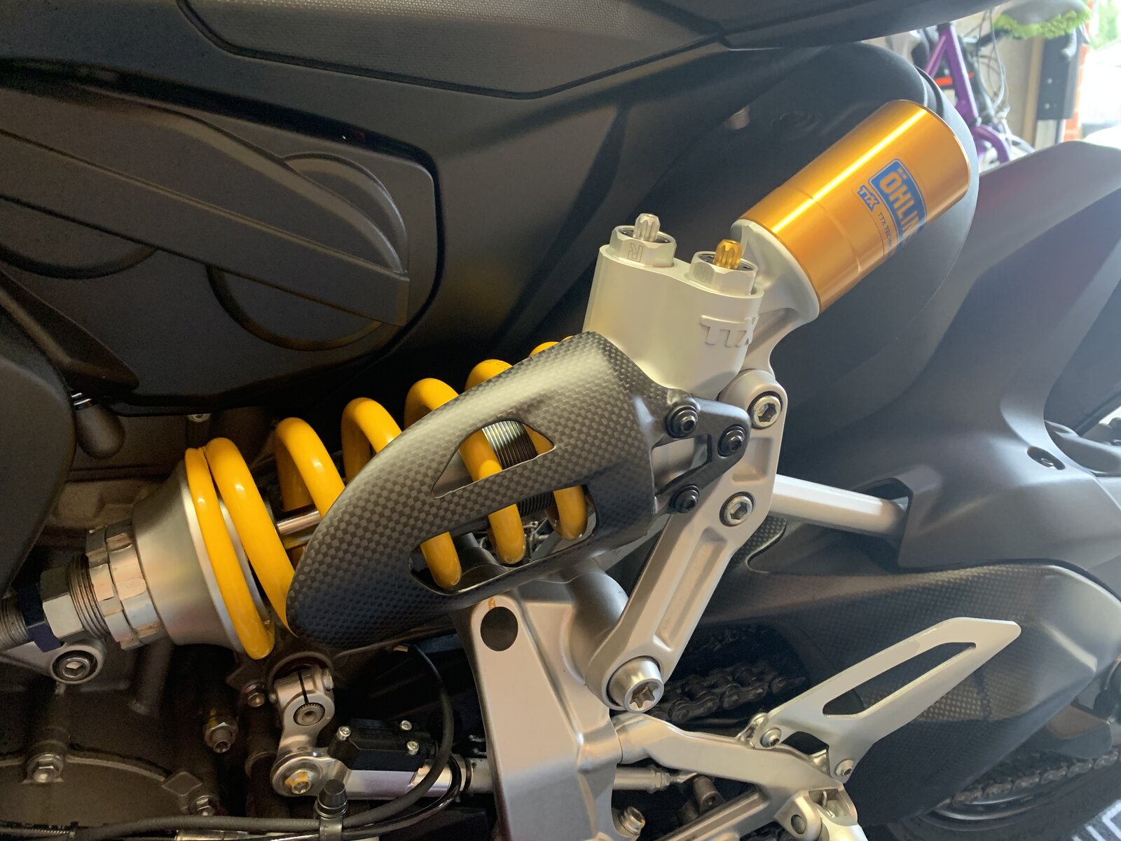

  3. Yeah it fits fine. Whether the length is exactly the same I’m not sure but the fitment is okay. I personally fitted a Ohlins TTX which was length adjustable and had come off a 899 so I just matched the free length to my standard V2 shock
