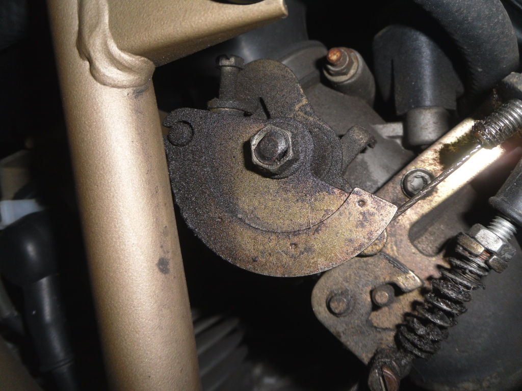

    Whip side panel off.

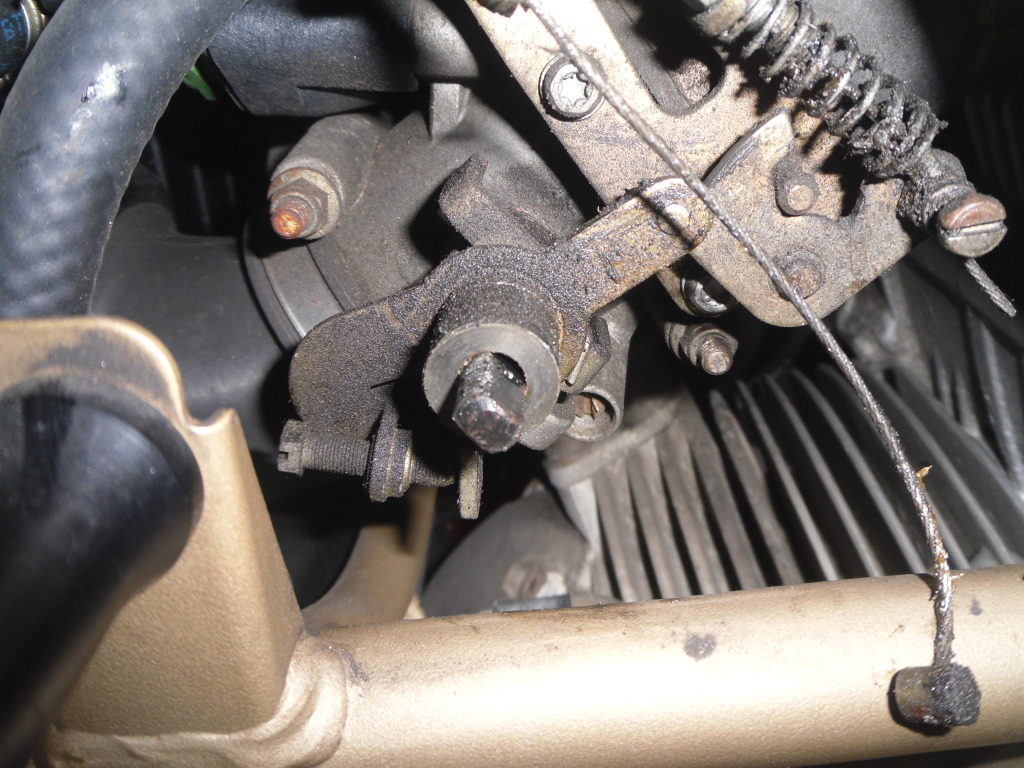

    Locate TB's

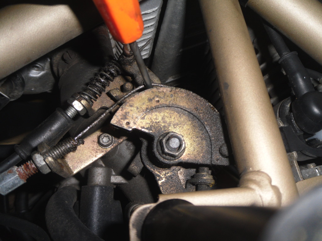

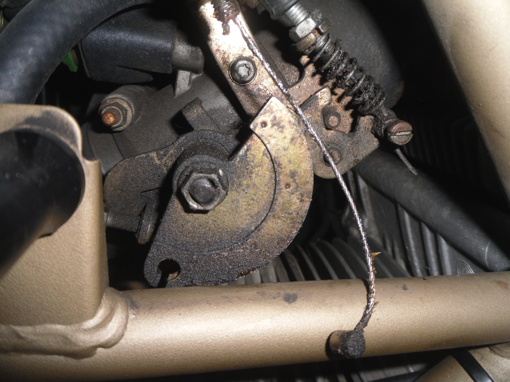

    Remove throttle cable. Throttle full open and then run a small screwdriver down the cable as you close it

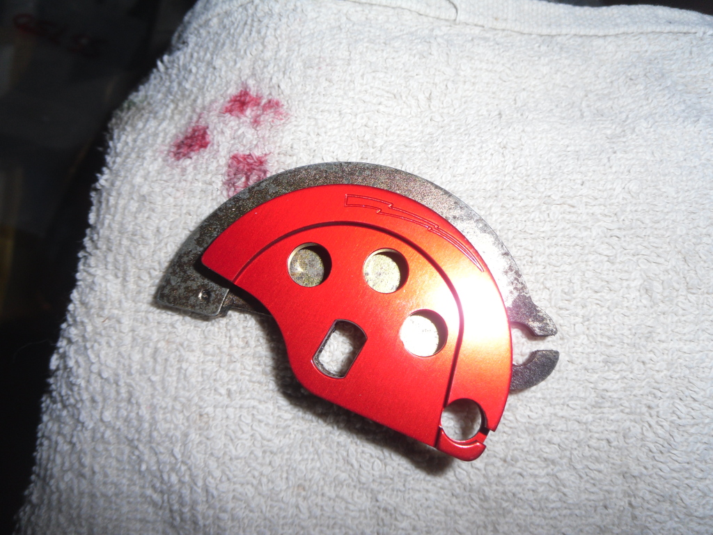

    One bolt to whip off the old cam.

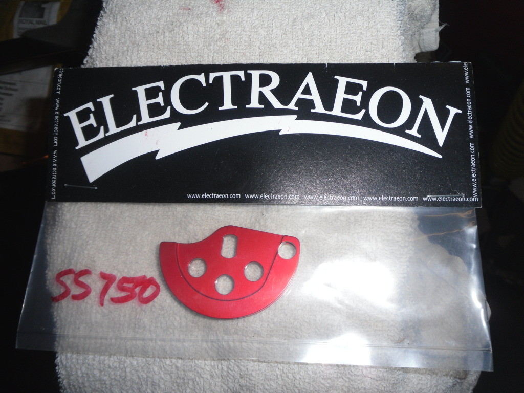

    58 Dollars gets you
    It is very light and CNC machined
    Lot smaller than the old one

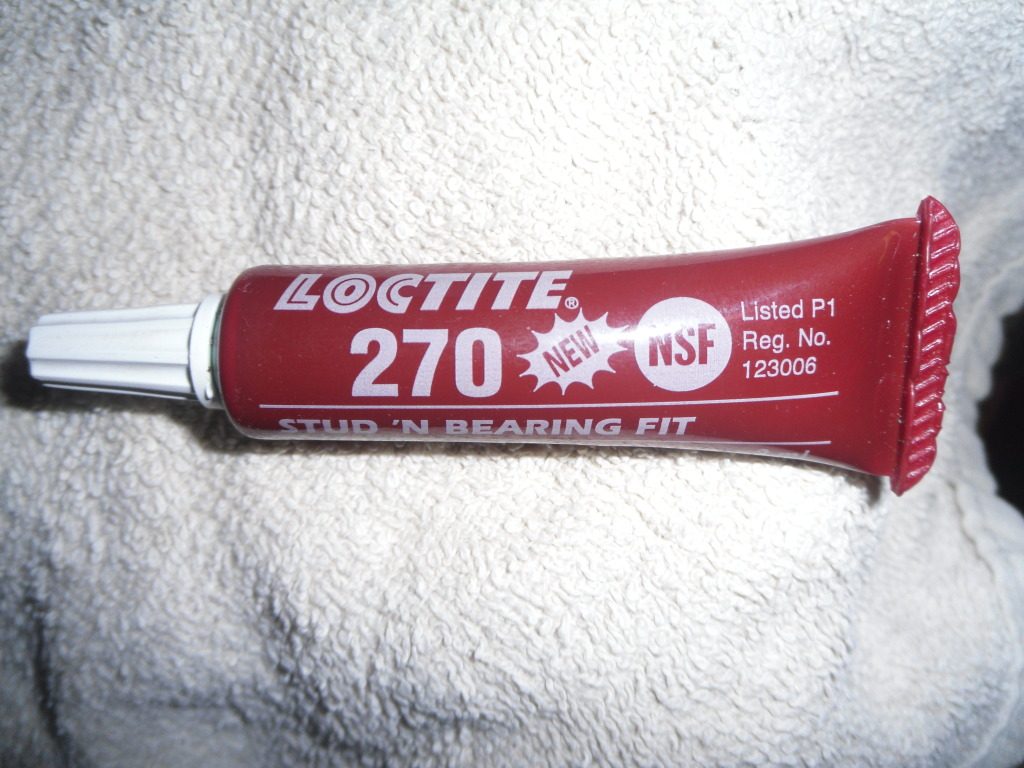

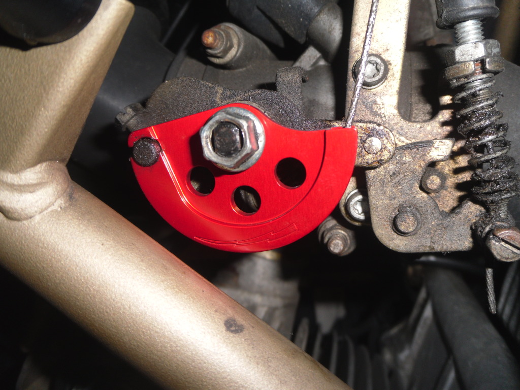

    Loctite the nut on ( I know this is the wrong type of Loctite but it was all I could find and due to it only having a little bit of thread it should be ok)
    New part fitted :tongue:

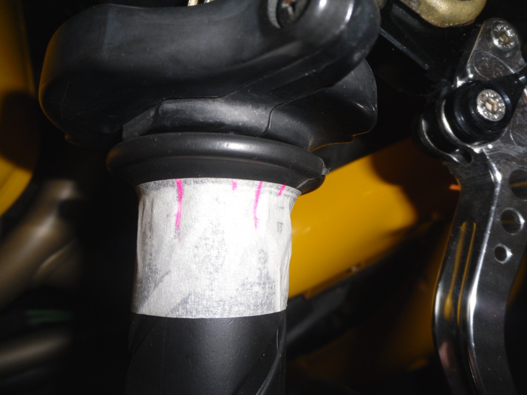

    The result is about 10 degree less movement not huge but enough.
    Cable back on and adjusted to the revs do not rise when you turn the bars lock to lock. (It used to rev its tits off on full right lock)
