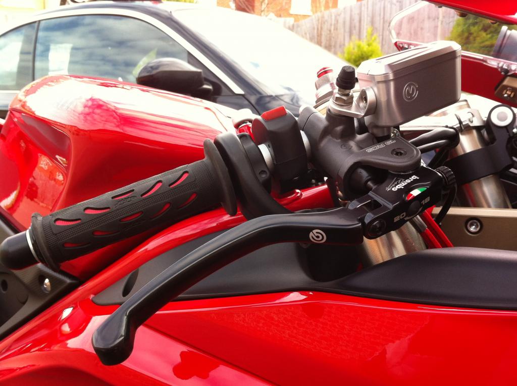

  2. Ah yes.
    When i did mine, i'd looked at the OEM clip-on and decided the clamp/bracket would foul it all up, so i bought some Lightech items instead, which have much leaner clamps.
    Whilst i'm sure some may argue i didn't need to - I err'd on the side of caution and it worked perfectly, see picture for routing of throttle etc.
  3. Addtional note - I binned the OEM 848 engine kill switch for one off a 996, which was leaner, and gave me more room to play with.

    Next issue is working out how to mount the reservoir.... ( I like the way you've done yours...)
