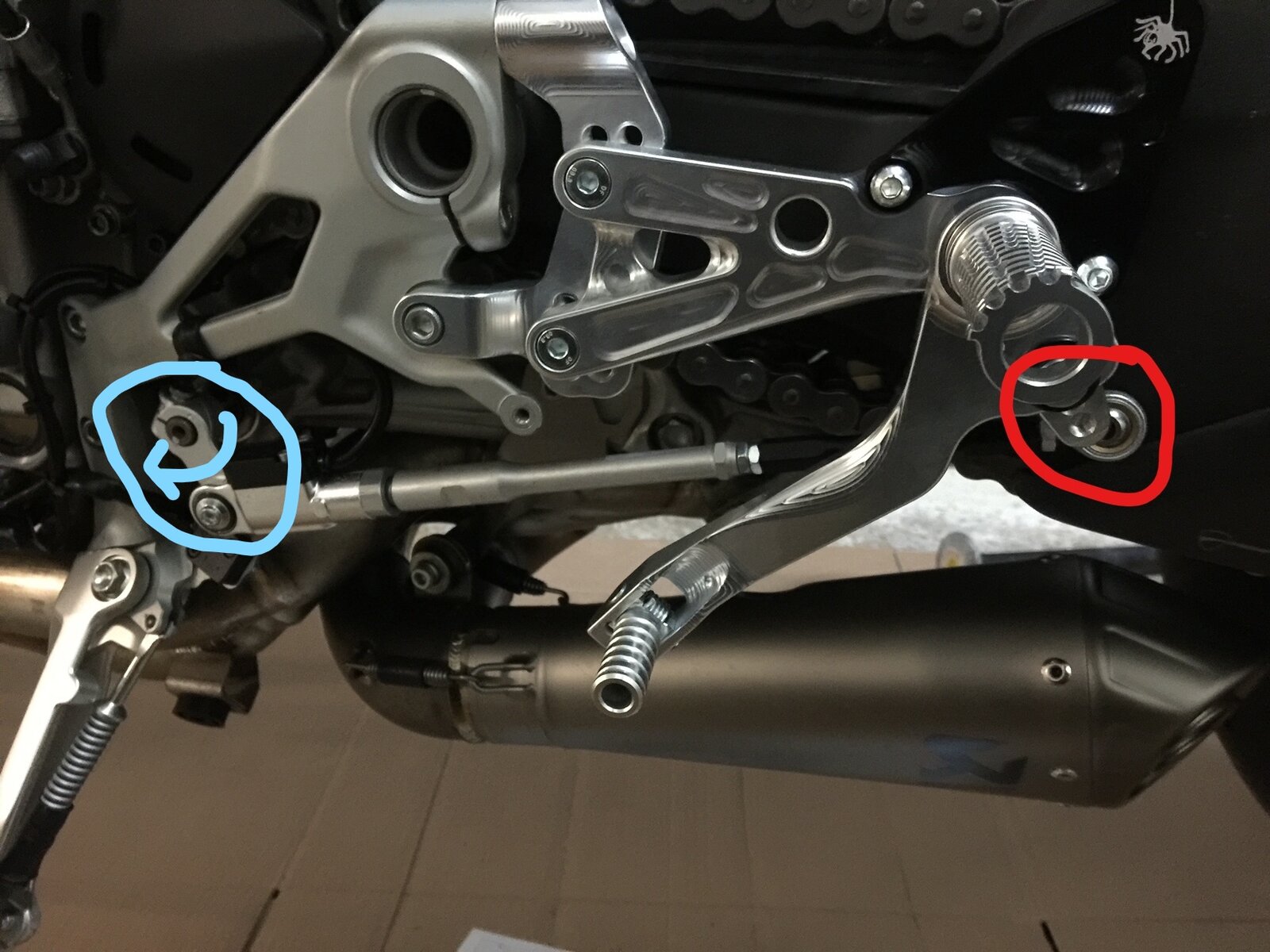

  5. Thanks all. I’ve circled the problem area in red in the attached photo. The photo shows the gear shift mechanism in the lowest position it will reach, and it’s still not possible to connect the uniball to the gear shift lever.
    the only thing I can think of is rotating the gear control lever that’s connected the the splined shaft and circled in blue clockwise, but I’m not sure that this is a sensible approach. Otherwise Dave’s suggestion of cutting down the supplied extender to an appropriate length sounds like it will do the trick.

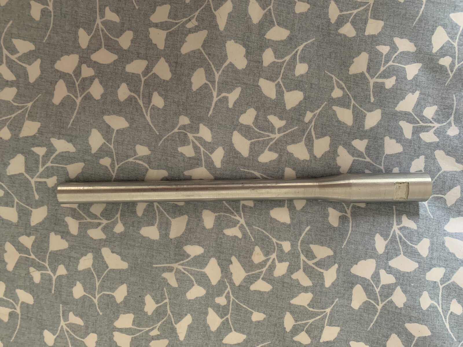

  6. I did this recently too
    I overcame the problem by making one of these
  7. Adjust it on the shaft mate.
    Remove the lever from the splined selection shaft and move it further round.

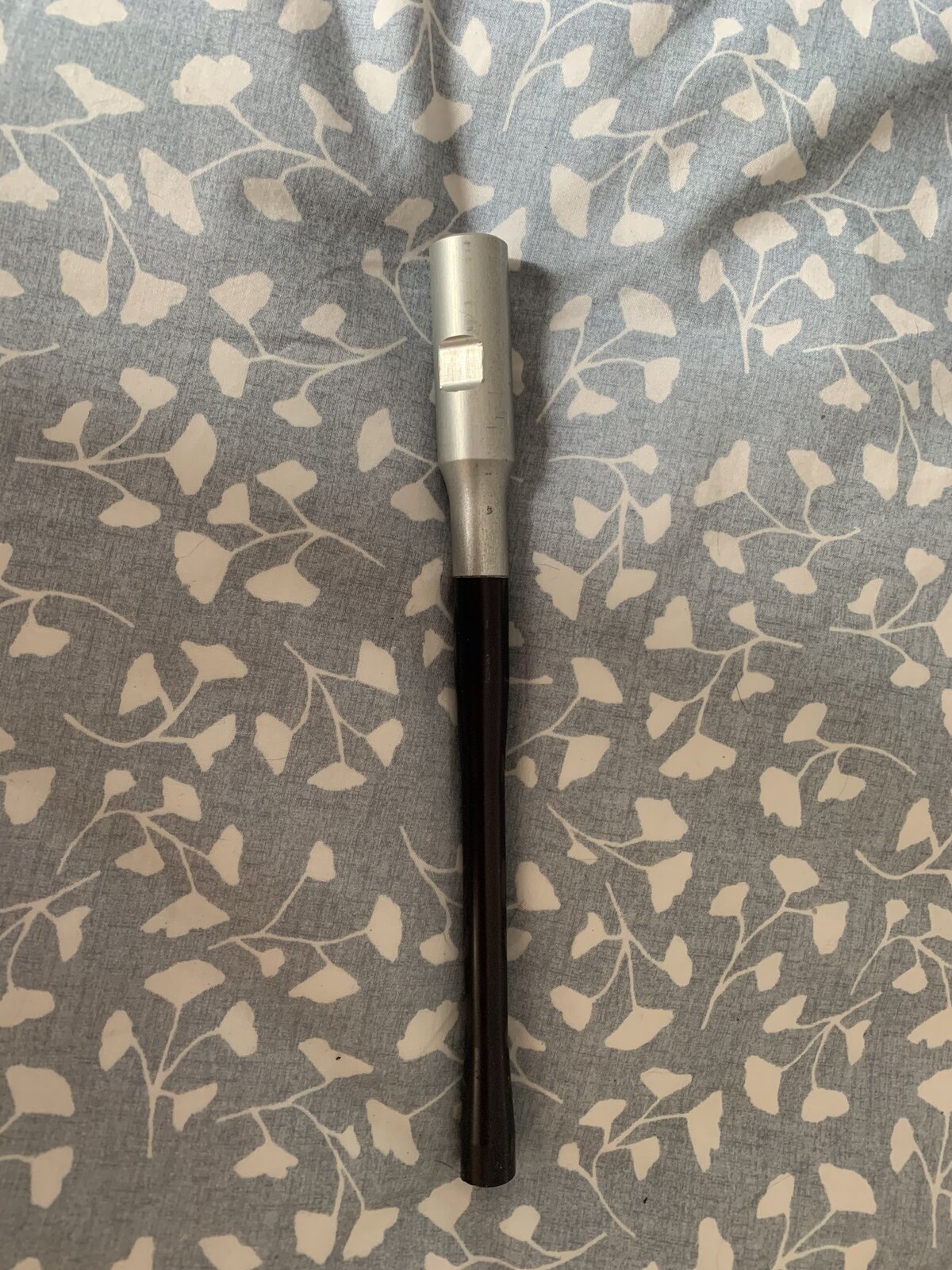

  9. 4EA1324A-3A6B-47C3-9F5E-DC82F21D00BD.jpeg I originally overcame with this

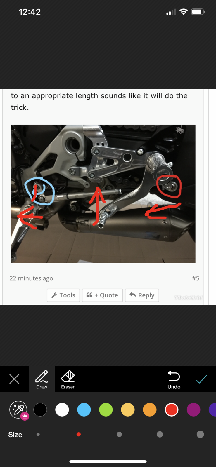

  14. Rotating on the shaft clockwise moves the linkage slightly forward (amount depending on degree of rotation). This should raise the gear selection and potentially give you the alignment required to join the uni bolt to the set no?
    I move mine around on the shaft all the time for various reasons. One being clearance and two comfort for different shifts etc for example
