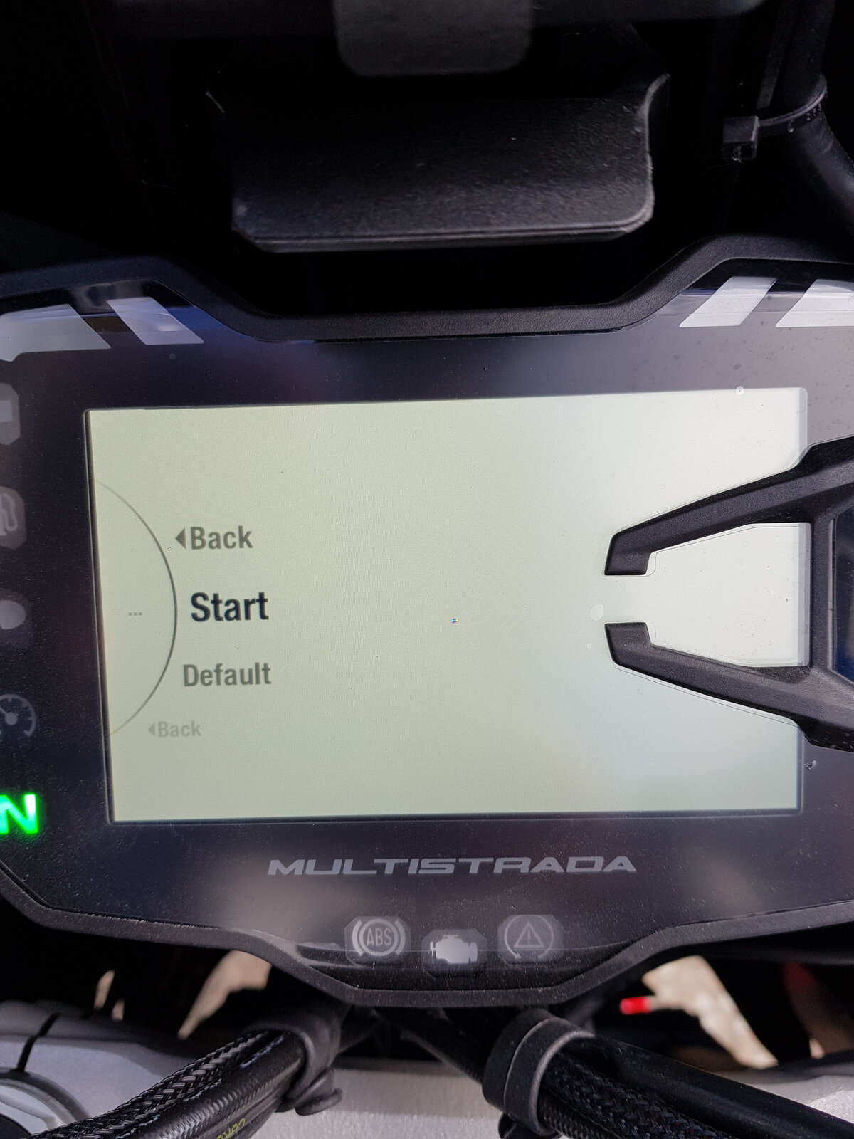

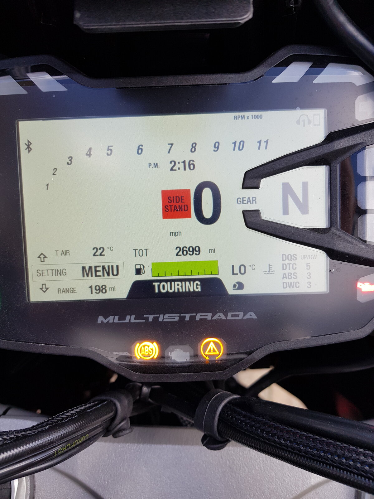

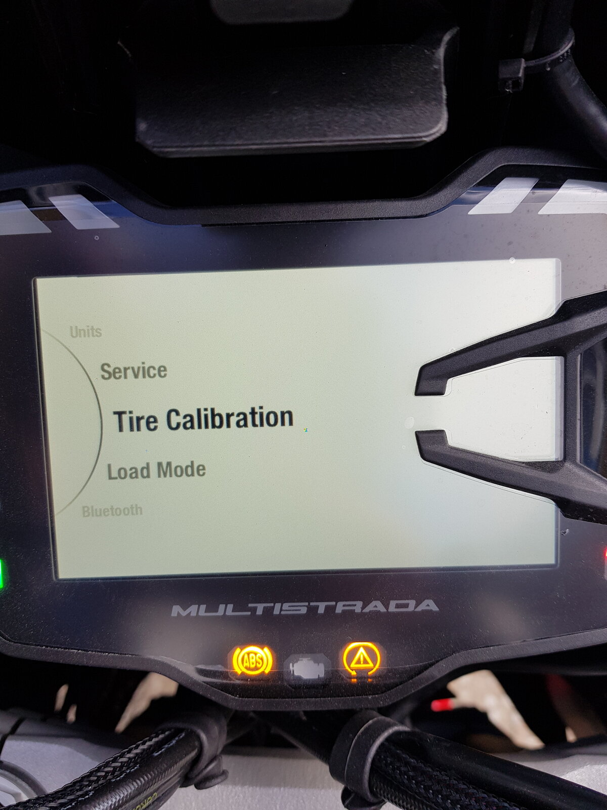

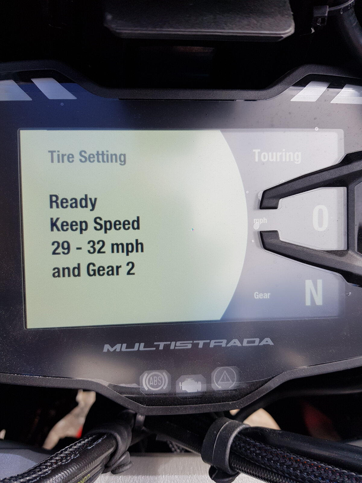

  1. I have a 2019 1260s touring. I changed my chain and rear sprocket down to 42 teeth and after that the quickshifter would only work when shifting up through the gears but would not shift down, no blip, nothing.
    Took her to Ducati Alton, they tried a new quickshifter but same problem. Anyway, long story short they sent a report to Ducati and came back with a very simple fix which actually worked.
    This resets all of the electronics and the process is as follows.
    Go to Menu 20200705_141640.jpg 20200705_141640.jpg 20200705_141645.jpg 20200705_141709.jpg
  2. Photos are in the wrong order but hopefully you get the gist.
  3. So I assume you go into the menu and then start off down the road whilst it calibrates?
  4. Correct
