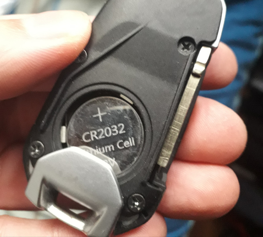

  3. I got it fixed just by replacing the small cell CR2032 3V batteries with new ones.
    They advised me on some facebook groups to change the batteries to new ones, so its a fairly known and easy fix.
    If the bike turns on when you hold the key fob close to the antenna as I did, the antenna is fine.
    The battery voltage should not be bellow 3.2 volts.
    The 2 ones I had that did not work good, had 3.0V and 3.1V.
    The new ones 3.2V so it took 0.1V to work perfectly, lol!
    When the voltage drops bellow 3.0V, like it did on an 3rd battery, wich read 2.9V, the bike will tell it as a yellow warning message on the screen.
    So from 3.0-3.1 you are in some sort of dead spot in wich it will work, but only if you hold the key fob against your antenna, without any message on the dash...

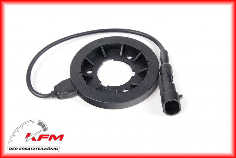

  4. wait a minute, whats the so called hands free unit you are talking about in your 2011 Multi that costs £393???? :astonished:
    I that the equivalent of the Antenna coil immobilizer on the DVT models?
    The so called passive unit? 51840091A
    Because that costs only 30-35 euro.....:rolleyes:
    Or is that active unit a third component of that whole handsfree system?
    Do you have a part number of the active unit, I assume its the same on the DVT's but havent found it....

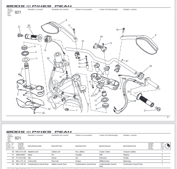

  5. Hi Riko.
    The hands free unit is number 30 below (for a 2012 bike). The part number has been superseded at least twice now. You've got one on yours.
    Your antenna is number 11 below. (for a 2012 model) I think It plugs into the hands free unit.

  6. No worries. I'm surprised your system starts to fail with just 3.0 volts present. Maybe it's a sign that the HFU is on it's way out? :thinkingface:- or maybe the antenna? :thinkingface:
    In your diagram it shows the part number for Japanese models (which work on a different frequency).
    Yep, passive function works without a battery.
    In UK the HFU cost is £328 + tax at 20% = £393. :sob:
