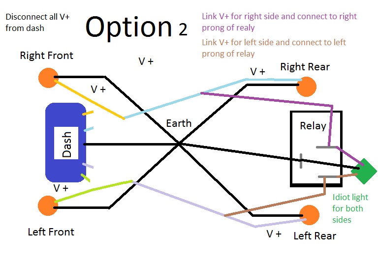

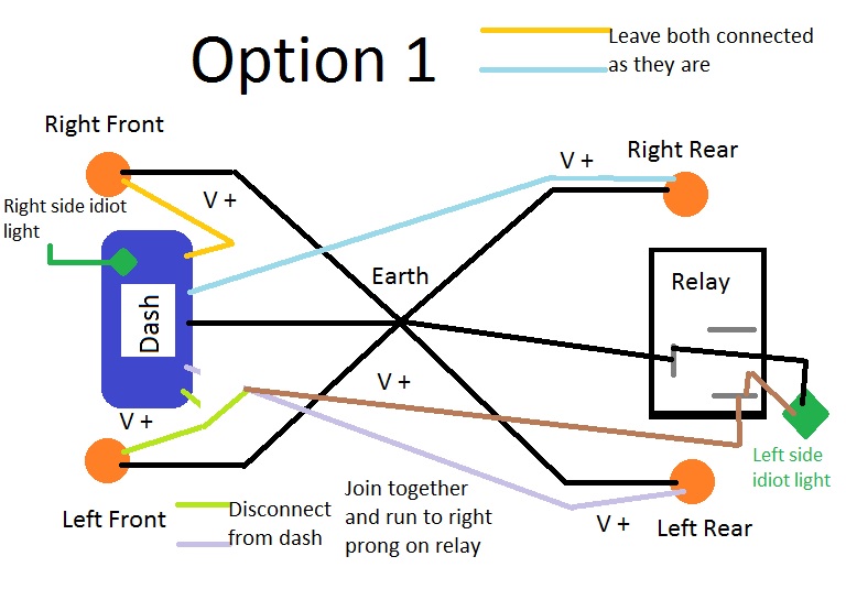

Ok so my baby monster has a damaged flasher that is built in to the clocks on m620 up. My right side indicators are working my left side is not. I can replace the dash or wire in a flasher relay. I am going for option 2. I have two options here one I know what to do so just need confirmation, it has a half baked solution. 2nd is proper solution. There is total of 5 wires going in to the dash from indicators. Earth that then splits to all for units plus + for each indicator going to their respective pin in dash. Option 1. I keep working side of indicators connected to dash, together with ground, keeping existing flasher to operate right side indicators. I then disconnect two V+ wires responsible for left side indicators, link them together and connect them to correct connector on flasher relay (left side to keep it easy) plus I tap in to ground and connect that to relay as well. Both indicators should be working yes? Existing led (idiot light) for indicators is flashing for right side indicators and previous owner installed green led in same spot for his fix. I run a wire from that led to same connectors on flasher relay (left and ground). Should then have green light for both side indicators. That option is half fix as the moment flasher relay fails completely in dash I loose right side of indicators and have to do it all over so prefer option 2. Option 2. I bypass flasher in dash all together. First few steps easy. Disconnect 4 V+ cables plus tap in to earth. Connect earth to middle prong on flasher. Join right hand side indicator V+ wires (back and front) and connect to right side prong on flasher relay. Do same for left side with left side indicators. Presto I have indicators. Am I right? Where it gets complicated is how to make idiot light working. I can use the already mentioned LED. To make one side work I just connect earth of LED to earth wire of flasher relay and V+ side to for example left prong of flasher relay. But that would only make it flash for left hand side indicators. If I were to also connect it to right side prong at the same time would it work or would 12V+ travel back to relay making both indicators flash or even relay burn up? Or is it that the 12V+ travelling back through loom would stop at indicator switch and never reach lights while relay would take the load? I want to use existing loom to minimize extra wires as much as possible. I also do not want to run unnecessary wires all over the bike. Till here it all looks easy but one more thing that escapes me is how the switch comes in to play here? I cannot find corresponding wires going from indicator switch to dash on electrical diagram. I guess there would be 3, earth and two V+? (not including those that go to the switch delivering current in first place as those stay intact).

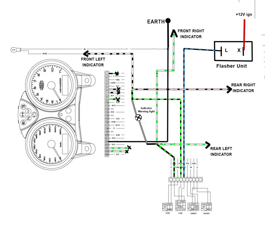

I can't see either of these working as you have them. Nor can I see a way of using the existing switch as it is to operate indicators from the dash on one side and indicators from a flasher unit on the other. The dash has outputs for each flasher , left front and rear and right front and rear and supplies 12V on/off to which ever ones are activated. The dash get's an earth from the indicator switch to turn whichever side is selected on. Flasher units normally have 12v from the ignition on circuit on one side. the other side going to the switch which makes the circuit to the left or right. When one side is selected the 12v goes through the flasher to the indicators which complete the circuit to ground turning the flasher on. You would need to fit a 2 pin flasher unit between 12v and the common wire to the indicator switch (Blue/Black currently connected to ground) The 2 White/Black wires from the dash (left indicators) would need to connected together and joined to the Green/Black from the indicator switch. The 2 White/Green wires from the dash (left indicators) would need to connected together and joined to the Blue/Green from the indicator switch. A separate indicator warning light would need wired across the 2 indicator circuits as you have above. If you like I can draw you up a circuit.
Derek please could you draw up a circuit so I can tackle this tomorrow. I have ID all the cables now by looking at diagram and decidedthe best ploace to go in to the loom is where it splits to go to left hand switch connector as there I should have all wires that go to dash and all wires that go to switch.

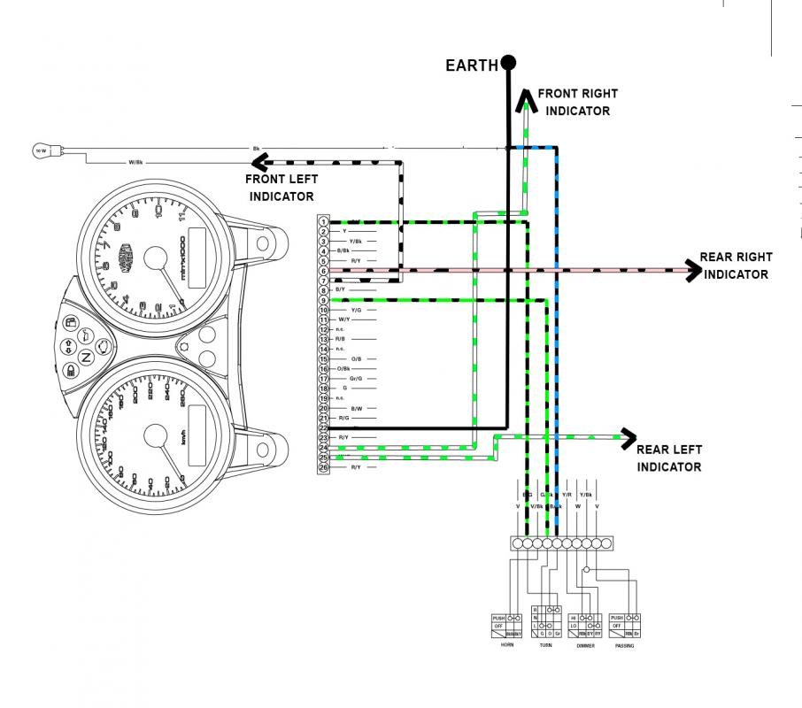

Hi Luca, Here are 2 diagrams based on the official Ducati layout. One shows the original wiring and the other the modded wiring to enable flashers without the dash. Note that the rear right flasher wire is Pink/Black not White/Black as I said above. It is probably best to make the cuts a few inches back from the dash connector leaving long enough tails so that you can re-instate the original wiring should you later replace the dash or get it repaired. The 12V for the flasher unit would be best picked up from the violet wires which supply the brake light, horn and headlamp flasher circuits.
Derek Thx, that looks much clearer now. I will cut in to them loom about 20-30 cm from dash. It is where the 1st set of wires that are indicator related are splitting off main loom. To be exact front head light as it also has indicator connector on it. That way I will minimise the wire needed for relay and will only have to run two longer wires to LED. Looking at old loom from 620 I can see all wires you mentioned including the purple one. so I should be good to go tomorrow. Indicator land here I come, next stop belts and tyres
I only just noticed that I labelled the rear indicators with left and right reversed. No matter, you got there.
I did not notice that as I used common sense for linking indicators and only then your diagram. At the end it is obvious both front and rear left/right need to link together. Now all I need to do is much longer cables going to the flasher so I can re-located to under the tank.
