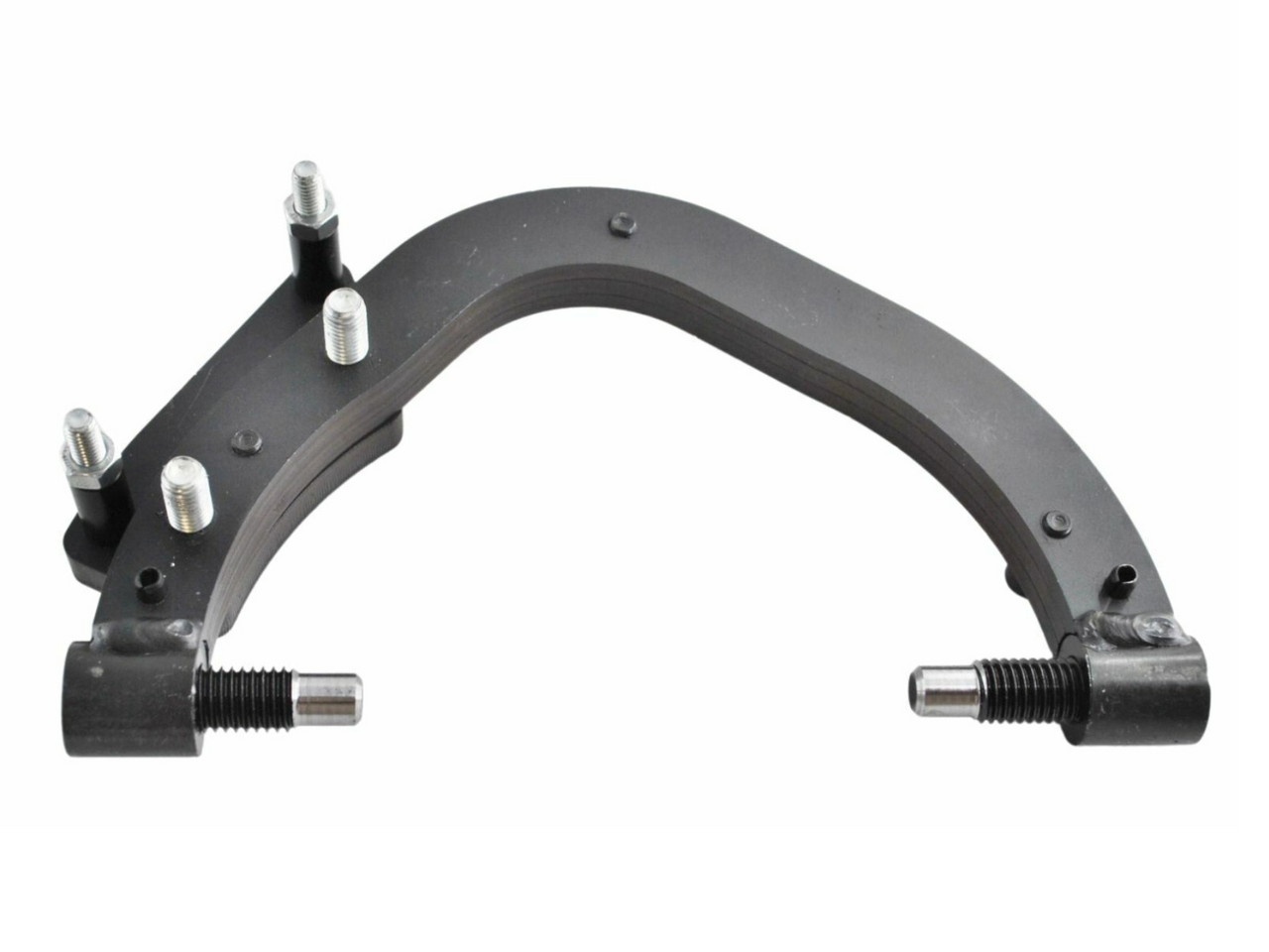

  1. A GB Motorcycles Timing Shaft Locking / Belt Roller Timing tool - part number 887133.367
    Only used once to complete a gear shift/return spring change so practically as new.
    Listed to fit:
    Multistrada 1200 Pikes Peak 2012-2013
    Multistrada 1200 S 2015-2016
    Multistrada 1200 S GT 2013-2014
    Multistrada 1200 S Pikes 2014-2016
    Multistrada 1200 Sport 2012
    Multistrada 1200 Standard 2011-2016
    Multistrada 1200 STouring 2013-2014
    Multistrada 1200 Touring 2011-2012
    Please see for further details on the tool:
    https://gbmotorcycleproducts.com/du...016-flywheel-holding-tool-part-no-88713-3367/
    £25 including postage to UK mainland. Payment via PayPal.
