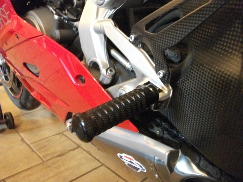

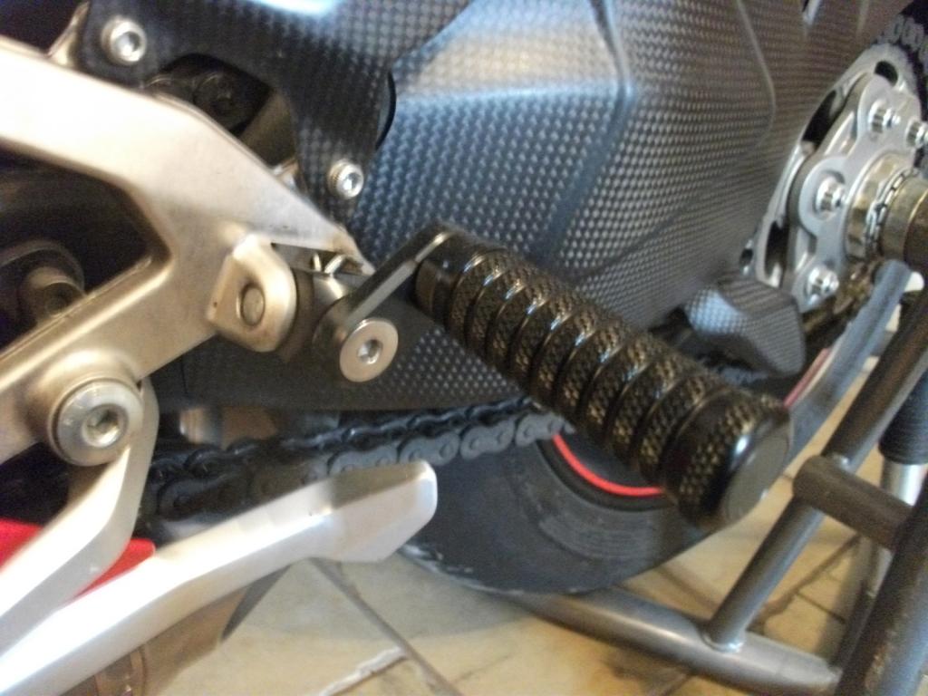

  7. It's one of the more simple jobs. Only took me about 10 minutes and I'm not at all mechanically minded. As Bob said watch you don't mangle the C clip. I just reused the old ones but did have to nip them back up into shape. I went for the M-Factory rotating pegs as I'm a lanky git. Much better grip than the OEM pegs. The adjustable positioning made it more comfortable but being 6ft4 still couldn't get comfy on them. I've since removed them (unfortunately and at much expense!!) and put full adjustable rearsets on my bike but I'd definitely recommend swapping the OEM pegs for some more grippy ones.

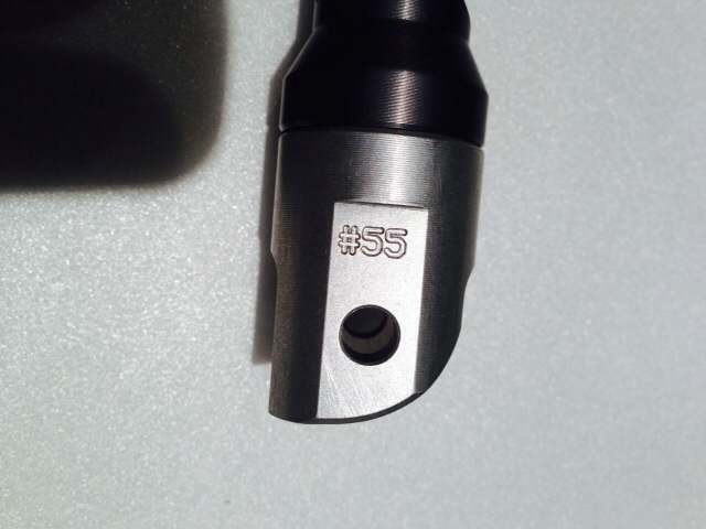

    Ive got #55 stamped on mine. Anything on yours?
    washer was trashed when I gently eased it off the pivot pin. Did you fit new ones?
  17. Can't see any numbers, where are yours?
    Amazingly for me I got the washers off and back on fine :)
    whats written on your carrier?

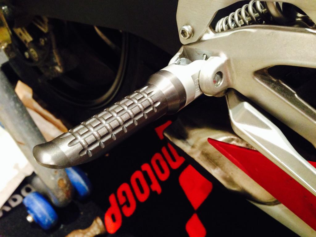

    Photo as requested. Oberon Titanium. Made in England.
    I think they look ace.
