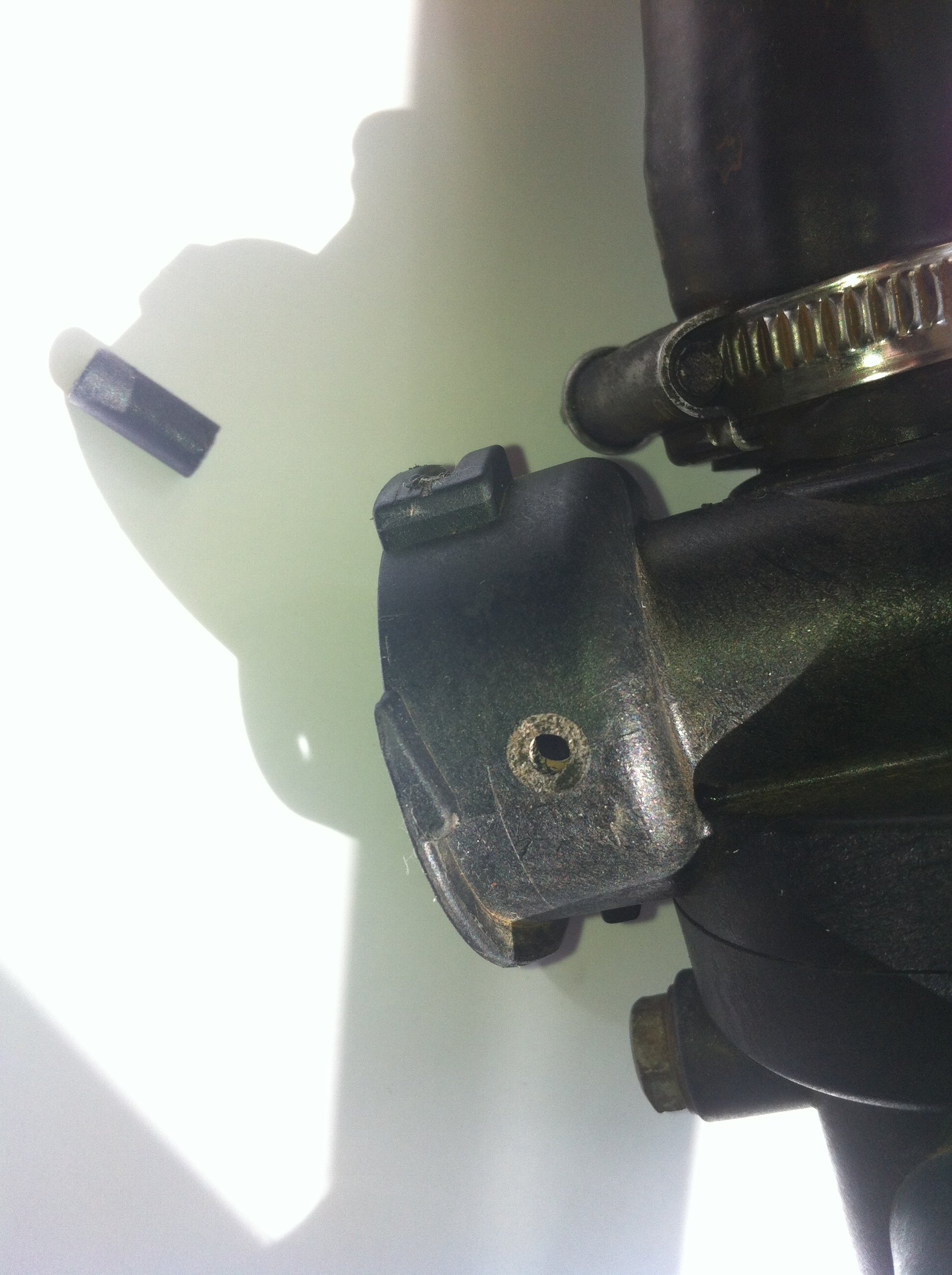

  1. I recently had coolant leaking problems on my Triumph Sprint St, the overflow pipe spigot had broken off the thermostat housing and coolant was leaking all over the shop.

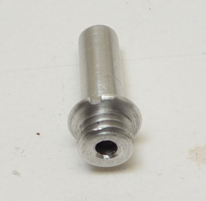

    I thought that a new housing would probably cost and arm and a leg, so I pondered ways to repair the snapped off spigot. Al ( Arquebus) very kindly offered to help me out, and after many exchanges of emails, and Al drawing up some proper technical drawings , he went ahead and machined the spigot in the photo which will screw into the damaged housing ( once I have tapped it out).
    Now offering to make the spigot is extremely good of him, but after he had made it I found out that Al doesn't have a lathe! He had made this tiny little spigot by using a power drill held in a vice and used a woodworking plane's blade held in his hand to fashion the various diameters.
    unfortunately my photo doesn't do his workmanship justice!

    Oh, come on FFS, it's a bit of ally turned into a useful (hopefully) repair for John.........easy peasy.
    About 1-1/2 hours to do something that I would have done if it was my bike.......
    I'm good at little bodges like this.......

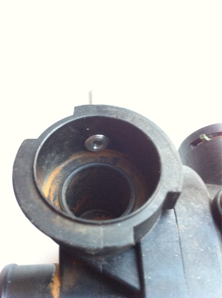

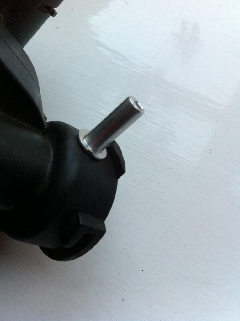

  13. Al's Spigot now in position after drilling out the broken housing and tapping M8.
    A good effective repair.[​IMG][​IMG]
