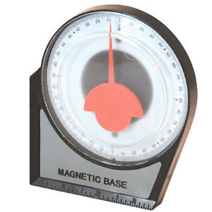

My angle finders cost £3.95 delivered and they're fab! You can see them on the pictures of my build on the head-stock I think. Just slot some long sockets in the holes and use a straight edge. (ps only watched the first few mins but will file for later thanks) INCLINOMETER Roofing Scaffolding Angle Measure Finder * MAGNETIC NEW MODEL * | eBay
