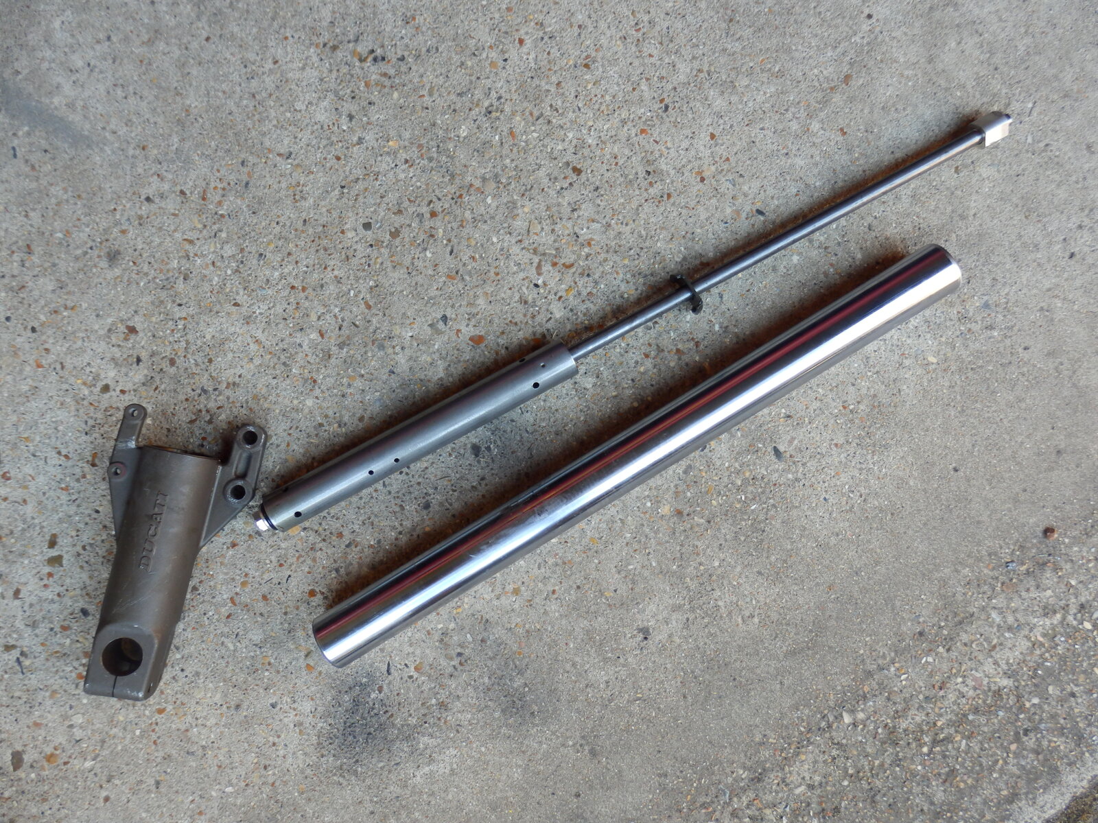

No, they’re bloody difficult to get off requiring lots of heat and suitable clamping devices that won’t damage the stanchion or the fork bottom.
As above, they seem to be held on by some sort of thread lock and they are very hard to remove, you need to use a lot of heat to even have a chance of removing them without damage.
I know it’s a Honda but this video gives an idea of what it needs to separate the stantions from the knuckle…
