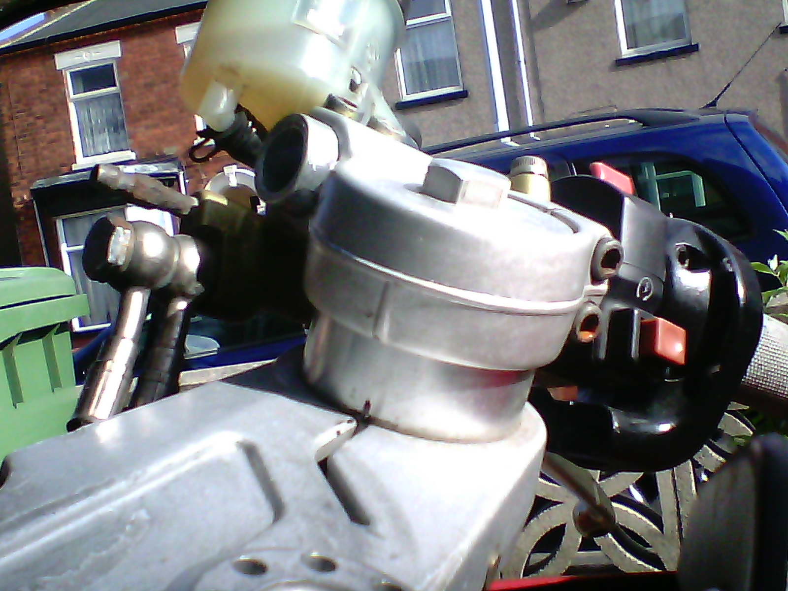

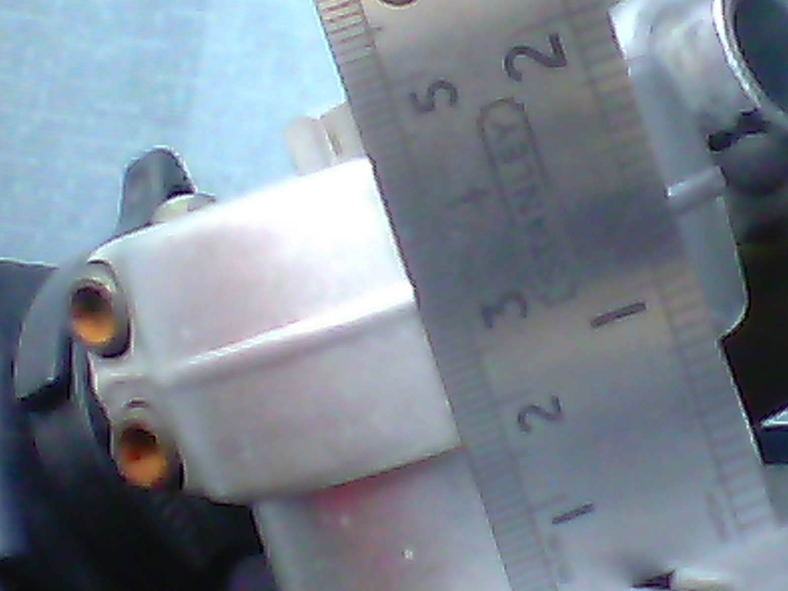

  15. Re: johnboys pics. That looks about right. My SSie had spacer rings about 10mm tall below the clip ons. I think my2000 on had higher bars for more comfortable position which is probably the spacers.
    Carby forks are shorter with bars fitted below the yoke. Overall ride height is the same though I think.
  16. here is some piccys of the bar clamps and fork tops on my bike have not altered the fork height on the bike since I got it but have raised the bars
