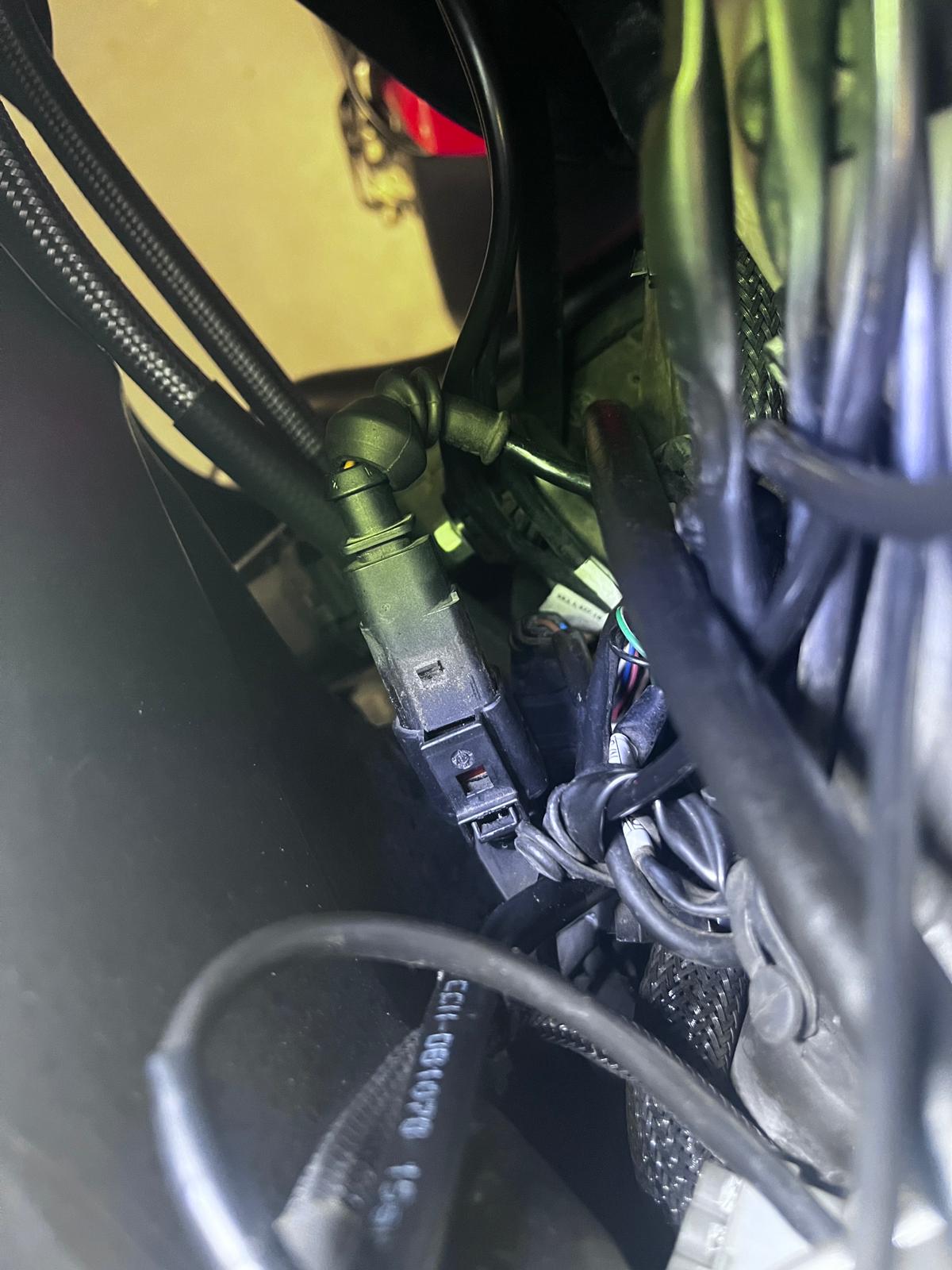

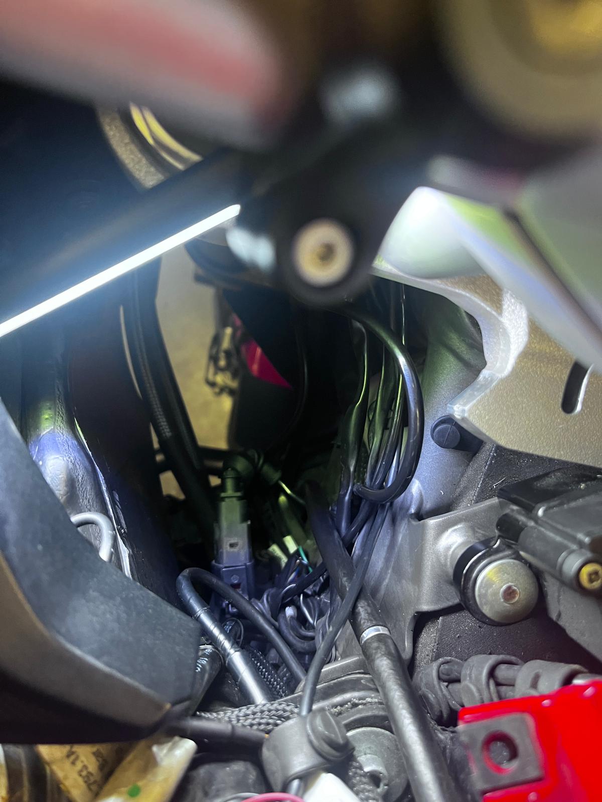

  10. I have managed to unplug the skyhook cable without removing tank, but fiddly but managed to unplug just as it disappears into/underneath the tank, mines a 1260 2018 and it may have been modified on later models, please pics attached. I still hope to remove the fork legs to enable me to, remove the fork carries to change the bearings. Ducati 1260 cable 2.jpg Ducati 1260 cable 1.jpg
  11. It is fiddly, and to be honest, once you've had the tank off a few times you get a lot quicker at it hence, probably just as quick to remove it rater than struggle.
  12. Ok in summary, I have managed to replace the steering head bearing without removing any if the main fairing panels, i did remove the left panel the one with the Ducati on it, as it made accessing the skyhook lead connecting plug am little easier as i have very big hands and finders. I though if changing the fork seals but if they do fail its less then an hour to get the fork tubes out, and an hour to get them back in. I did use a sky jack that made my life a lot easier.
