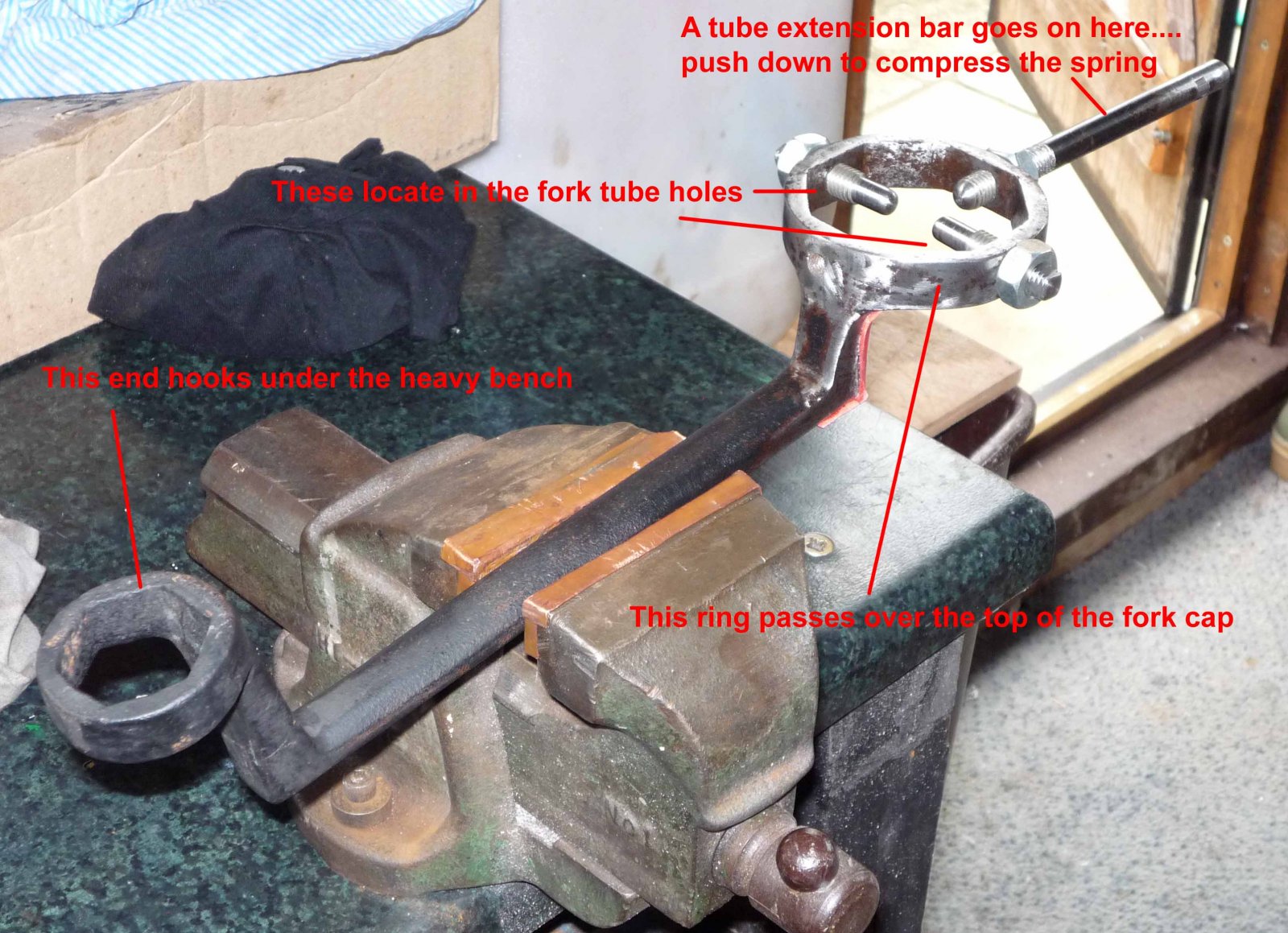

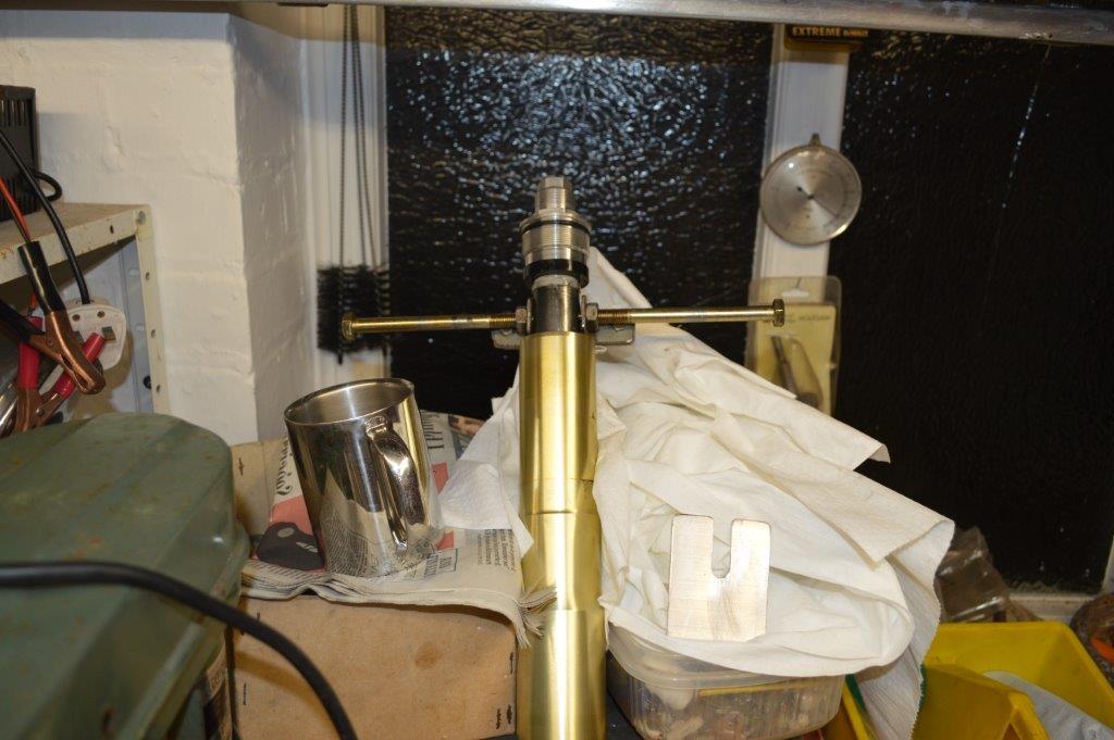

    Ive just come in from garage after making the tools, heres a pic. Ill have a go with them tomorrow.
    Great tool!! Think ill get an assistant.

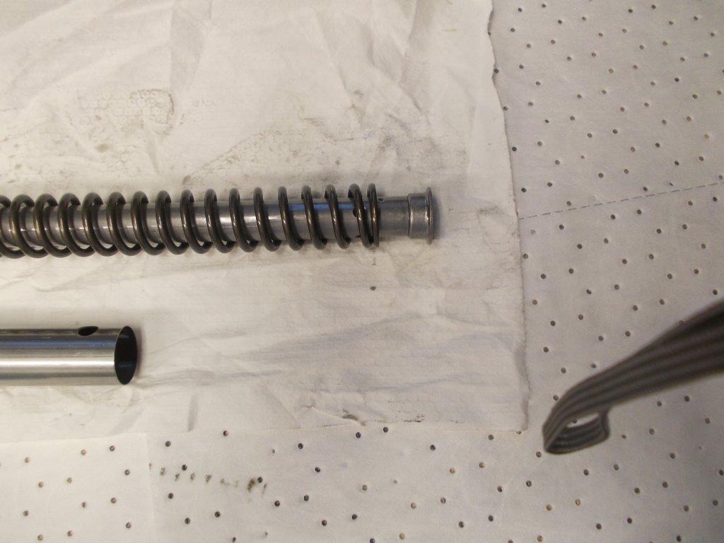

  13. Got the forks apart, cleaned them up ready for some nice new oil. Took the damper rod out, theres a centring bush at the bottom, it fell out when I turned the fork upside down, just checkin what way it fits??? is it as per the attached pic??
    Cheers,
