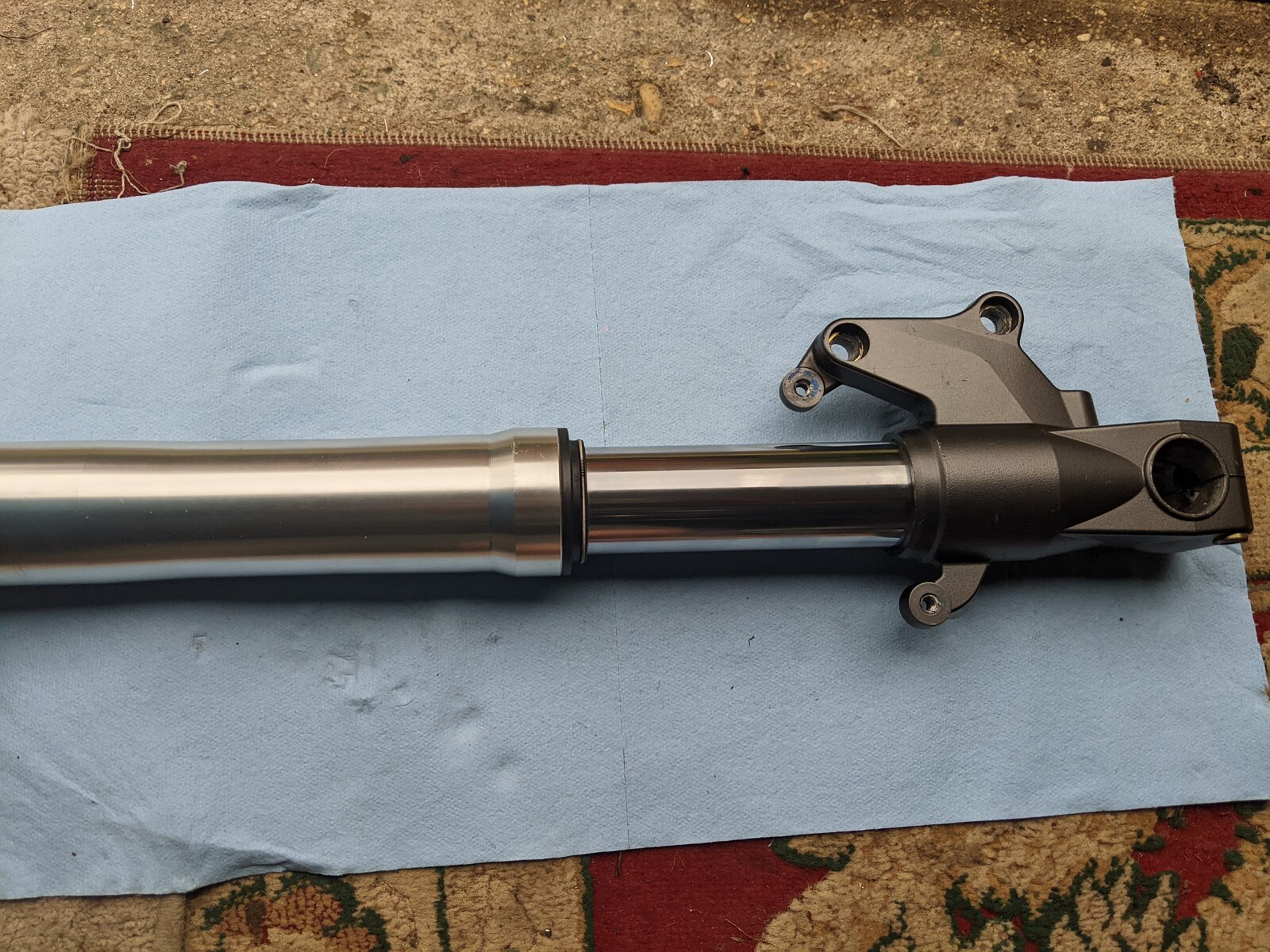

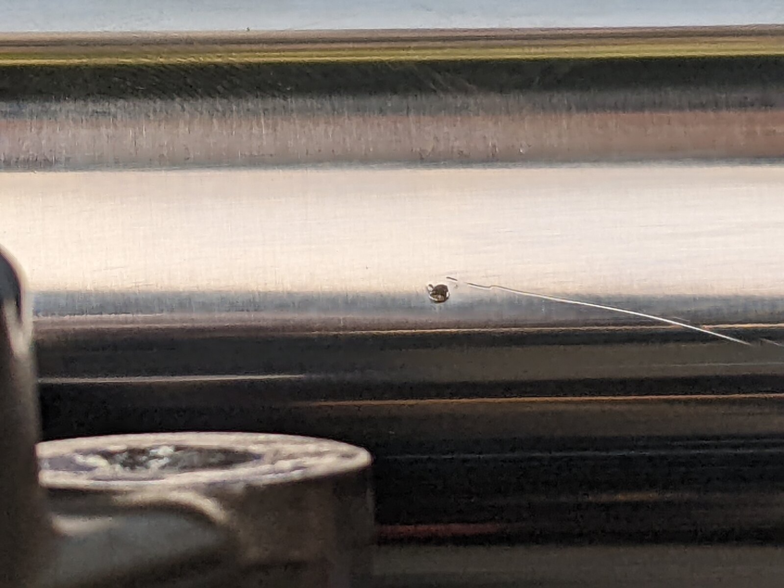

    I've bought a pair of used complete forks for the V Raptor because the ones on the bike are 70k miles old and pretty much destined for the bin.The tubes are heavily pitted, the caliper foot mounts/casting are knackered, pinch bolt thread gone awol, mudguard lugs oxidising away etc. Plus the upper stanchions are well pitted & scratched.
