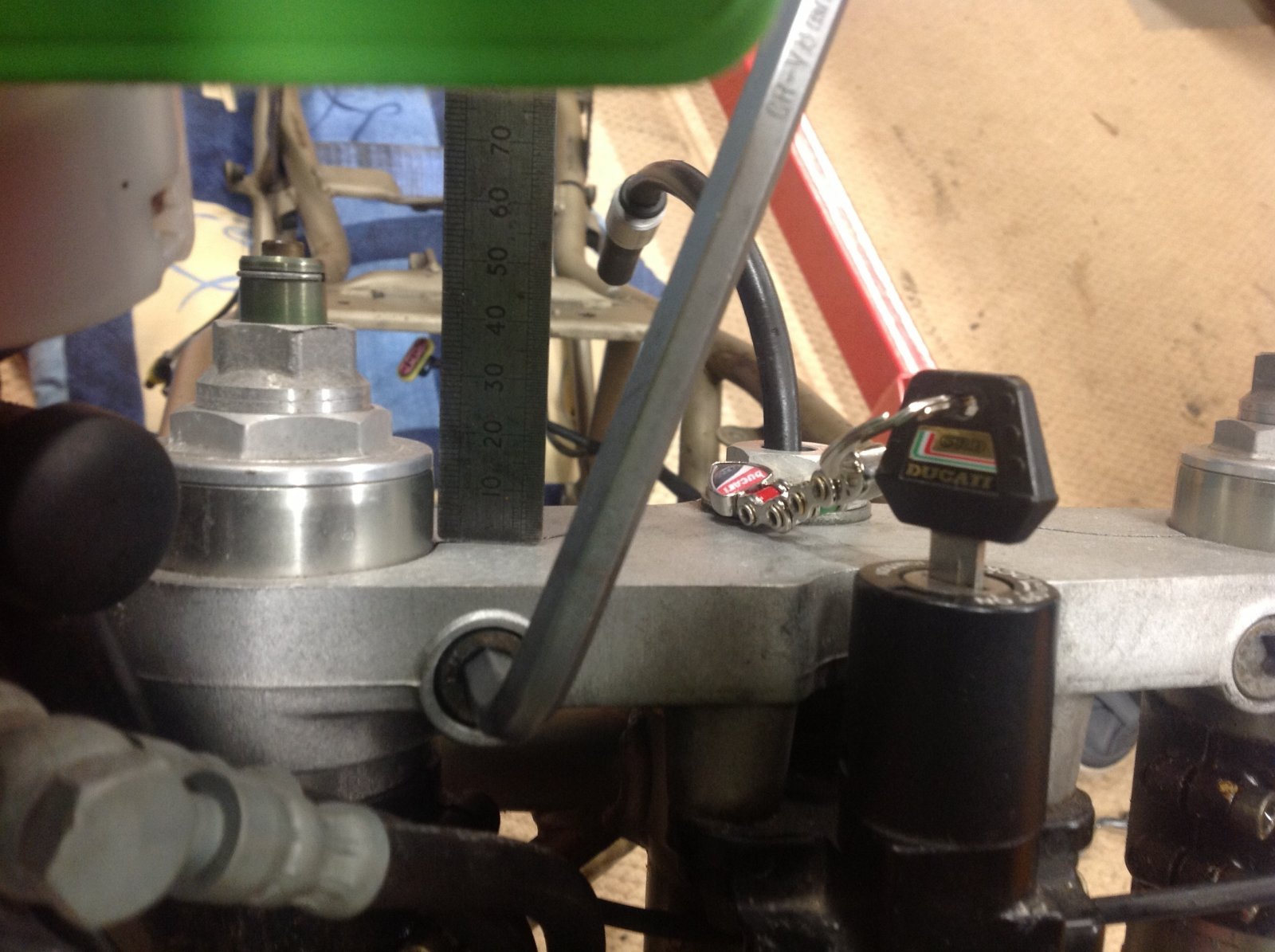

  2. I measured mine before I stripped the bike for rebuild, not sure if this is the set standard position though. image.jpg

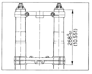

  3. My memory was wrong, it is more, i have it at a smidgen under 20mm. Cant see it making much difference if its a few mm of the standard
