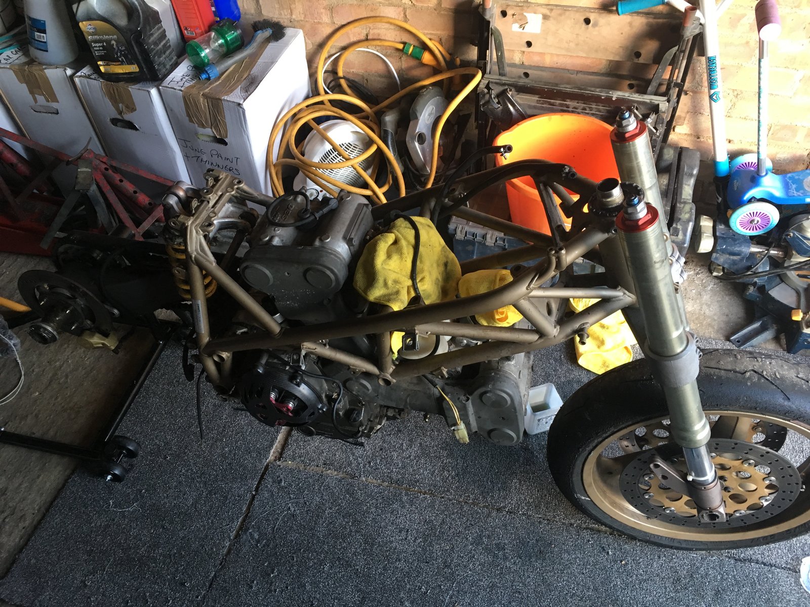

  1. Just been quoted 150 , is this expensive ?
