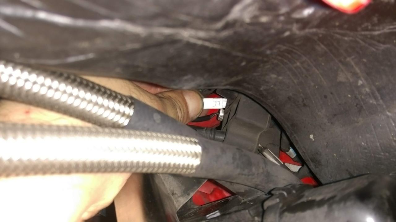

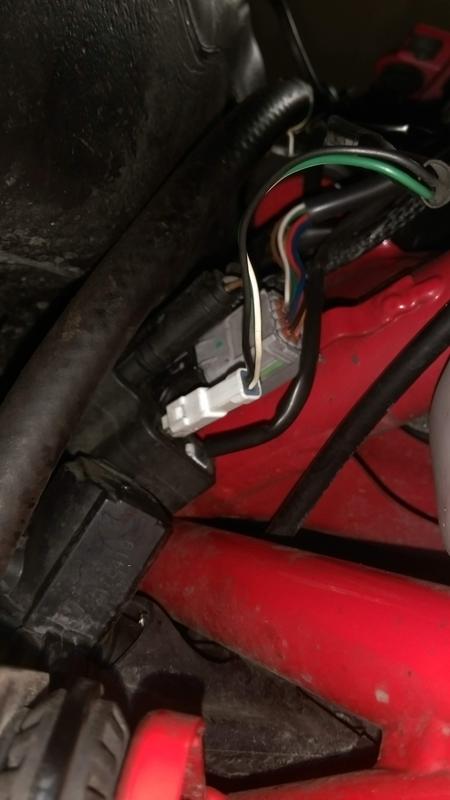

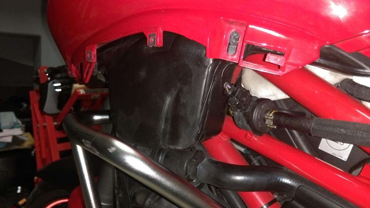

  4. okay, first of all, bullshit to remove tank, to remove anything in that matter...
    I just wasted hours spending removing tupperware while it was not needed.
    I do not know how the mechanics do it, but how I reached the connectors was in a difficult manner.
    The problem is that the connectors are under the black blocks under the plastic tank cover....here is the left side.
    I suspect that much more needs to be removed to get that piece away to easily approach all the connectors behind it.
    But if you 'simply just follow' the cable, you will find the connector at the end, only they are seated in a rubber housing of some sort and are very difficult to reach, especially at the left side.
    However from the bottom of the bike, with patience, you can reach em and with some tools for the left side, you can get it out of the housing.
    This is the easy side, the right side:
    Here the connector can be easily pulled out of the housing to disconnect the connector itself:
    Than we have the left side >:)
    The cable is hard to track to the housing, the housing is even difficult to see, so its all on feeling.
    I managed to use one long plier to keep the connector out of the housing and with a knife and some heavy fiddling, I managed to push the pin in so I could pull the connector out, all with the same knife, so i think I might have damaged the receiving female connector in the process, but in the end I could connect my new blinker into the connector.

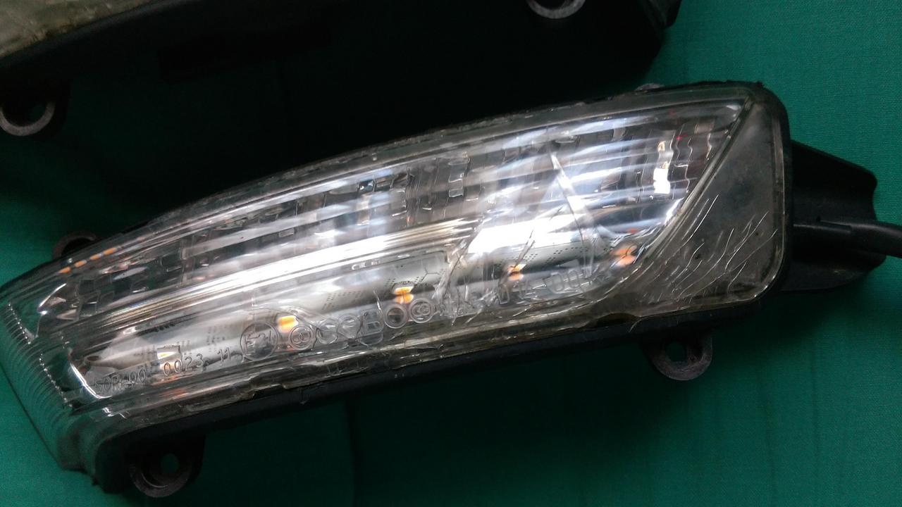

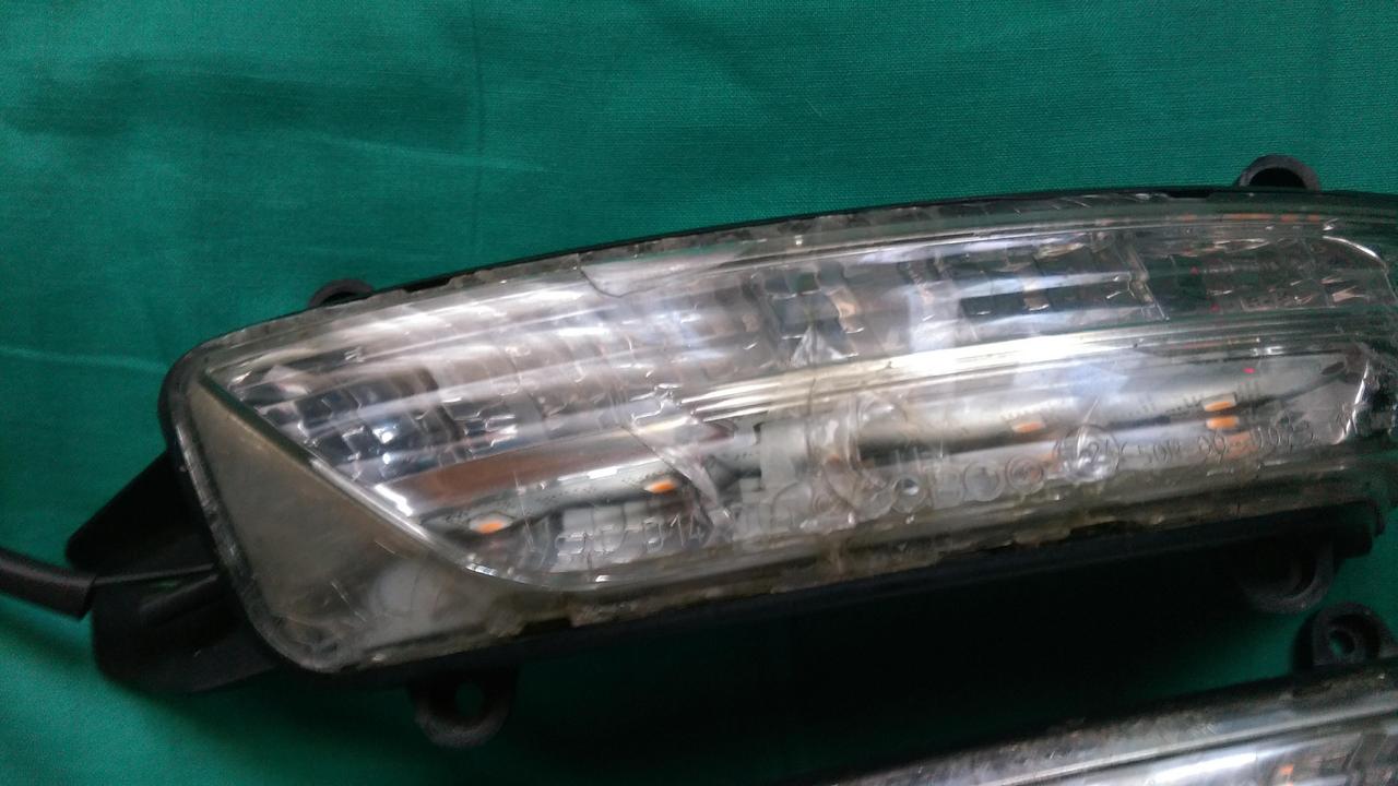

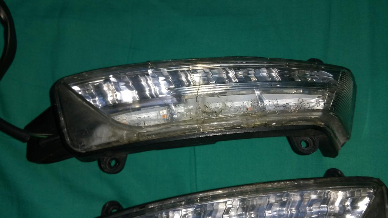

  5. here are the old blinkers with broken worn lenses

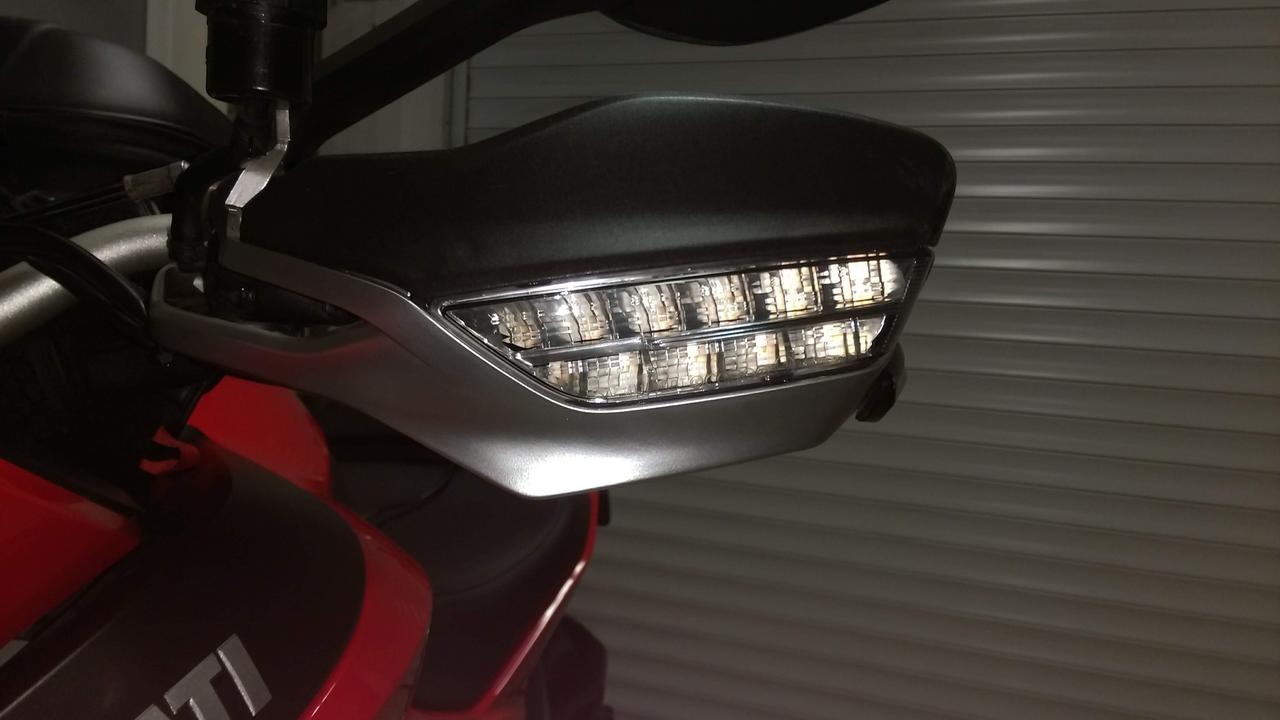

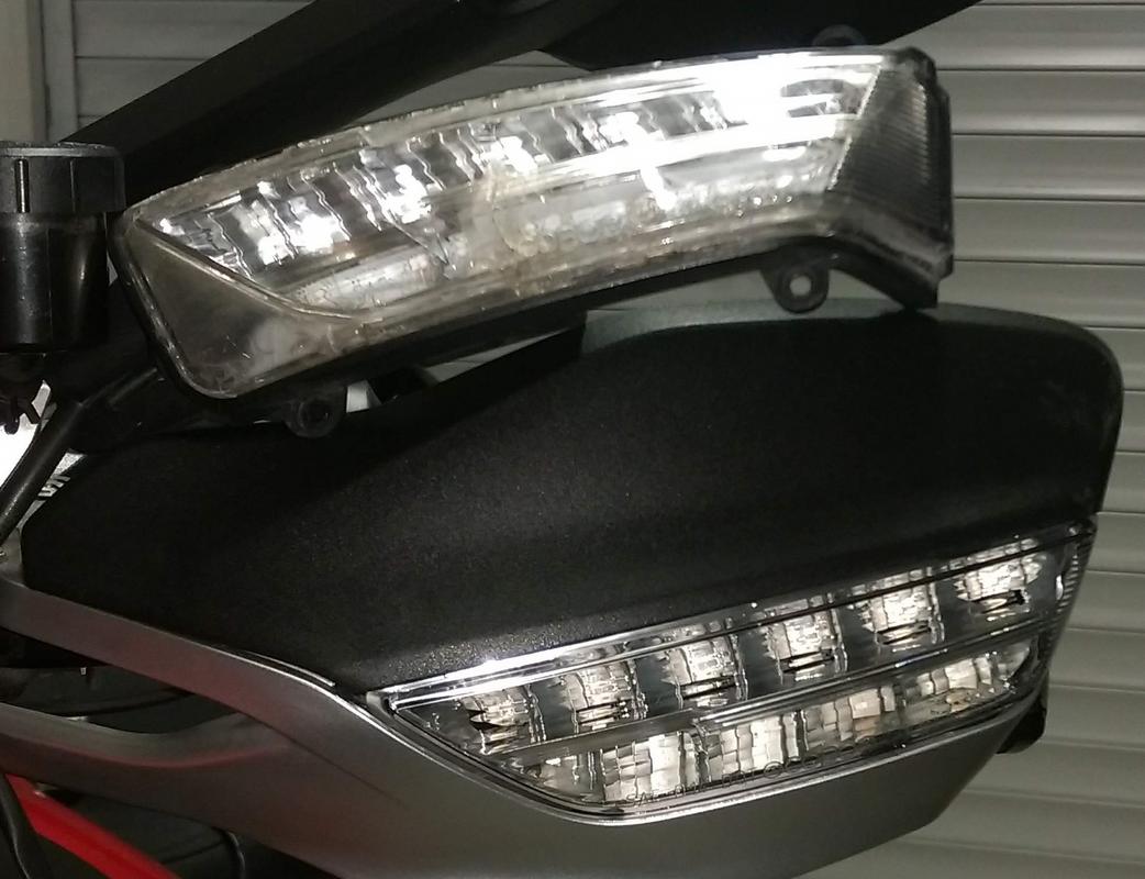

    here the new[​IMG]
    2 questions.
    1. am I the only one? seems so ....
    the bike was a loaners bike from the dealers but still, how does one explain those worn lenses?
    2. if not, is the quality of the lenses that bad they cannot endure frontal debris from high speed riding?
    On the other hand, the only 'debris' I can think of on that height, are flies and bugs etc...I dont see stones go that high, especially since all I do is road and highway and zero off roading.
    Strange huh

  8. Blinkers do dry-out and crack if not maintained.
    That's what this stuff is for.
  9. Oh my giddy aunt, they're in a terrible state for a 3 year old bike! Before you ownership had it been underwater?
    Not as a submariner but in a flood, I ask as I have a 2017 and mine are perfect at 16K miles!
