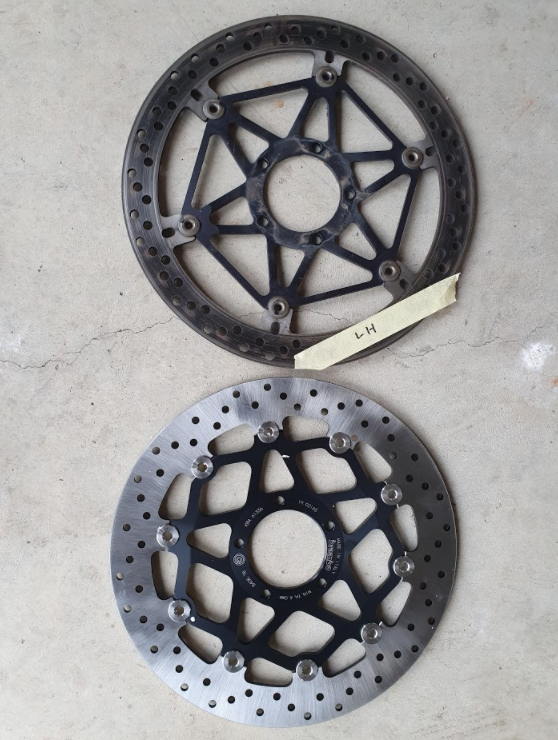

  4. This is a common problem due to the very light weight OEM discs the bike comes with. Same problem on my 2015 1200S after 29000km when i bought it second hand
    Replaced it with some Brembo series 1 discs - as the picture below shows, the top oem has substantially less metal to soak up heat (Series 1 shown below)

  6. Thanks for the replies ! Bobbins appear ok , brakes have always been free from the discs . I’ll contact my local dealer and enquire about any goodwill before I replace the discs .
  7. Don’t rule out the Series Oro versions if you have to replace.
  8. All sorted ! Bobbins had seized exasperating the pulsing feel when braking . As there was no wear on the disc a little sanding of the left disc sorted a slight distortion !
