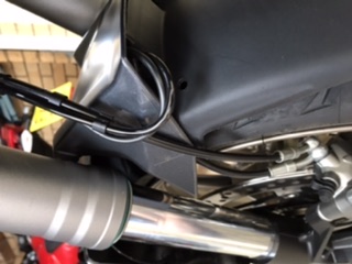

  8. Forgot to add yesterday ... am I missing something here what’s the hole in the mudguard for? F0967B5F-17D0-43FF-A443-D01312B2C8CE.jpeg
  9. Good Question - no idea, I asked the dealer the same question and they don't know either!
    Maybe that part fits on other Ducati Models and has a use on those?
