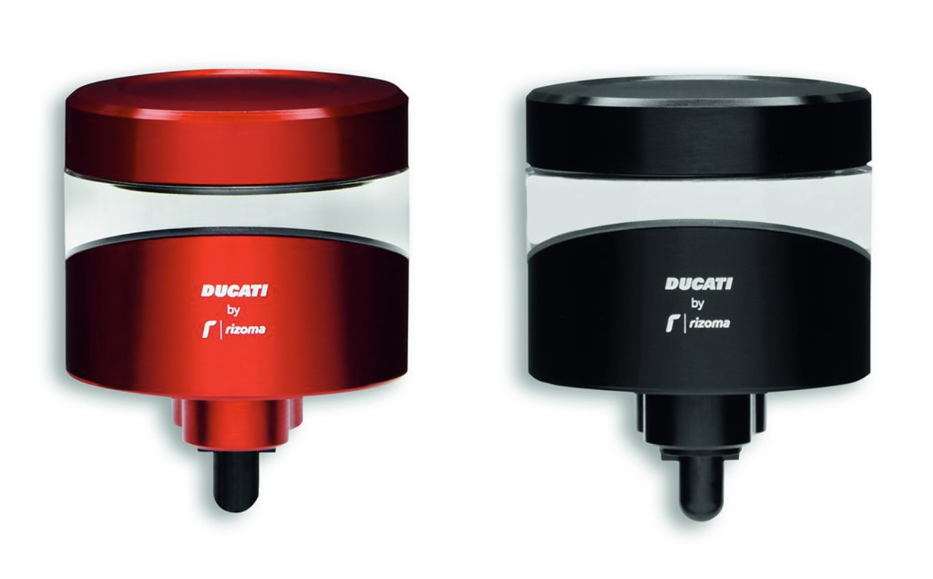

  6. I'm now looking at replacing the brake and clutch fluid reservoirs. I was looking at some Ducati badged rizoma items, the price of which make my eyes water.
    There are a couple of fitting kits but I'm not sure which one i need so emailed Ducati Manchester to ask.
    The reservoirs are £90 a pop! I mean, really? Now, while that seems expensive, the cheaper fitting kit is about £40 and it is comprised of two bent bits of metal and two, 3" bits of rubber hose. What the raging fuck! Surely that's just ripping the piss!
    Breath slowly and deeply, think beautiful thoughts and relax.
    Anyway, has anyone tried them and got any positive or negative feedback?
    Does anybody have any other, preferably cheaper, suggestions?
  7. About £16 versus about £220. That’s a powerful argument for the Chinese parts. Not sure about the fit though, I’d need to check that out.

  10. The resevoirs look exactly like the Brembo pots on my Monster, so I think they would fit the original bracket. I have bought the covers to replace the very corroded lids on mine, they fit perfectly. Outlet fits onto a EPDM rubber pipe so I wouldn't have thought it be an issue - I replaced my grotty looking hoses with this - https://www.demon-tweeks.com/brembo...nxLgOCrtg3MLoJC_EvBoC7x0QAvD_BwE&gclsrc=aw.ds
    Which was because I was uncertain of the bore - 6mm incdentally.
  11. I guess we know where the Chinese got their “inspiration”. :)
