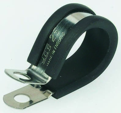

Thanks for the reply, Ive just realised/thought I can pick up a rubber P clamp and use the existing bolt fixing (maybe a little longer bolt needed) which fixes the original clamp on.
