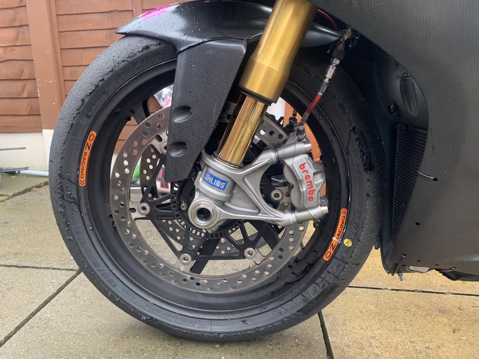

  1. Has anyone ditched the ABS on the V4 and got some straight lines (caliper to master cylinder) noticed the Stylema calipers have the nipple on the rear and the banjo on the front which is the opposite way they were on the previous M50 caliper and my fancy Hel dry brake lines now don’t fit as they foul the tyre.
    had a look around the forum and even a lot of track bikes I see have just left he ABS on... I’m starting to realise why now :tired_face:
    So just wondering has anyone bought a set of lines for their V4 that fit comfortably? If so where from? Or is anyone selling some GP4RX calipers :joy:

  11. I ran Hel lines and bypassed the ABS module on the 1299. No issues at all.
  12. Good decision! When I rode my R1 I knew right away I had to completely get rid of the abs and I did and it’s spot on! Rode my v4 and to me the abs isn’t a problem at all even when I pushed it! Gonna leave mine!
  13. That’s good to know. I ditched it on my R1 as it was a nightmare... didn’t know if the V4 would be similar. :upyeah:
  14. Can’t you just tern them all off on a Ducati? I know you can’t many brands but thought with Ducati you can
  15. Euro5 means nope, can't turn it off. You can turn down intrusion and I'm guessing by what @Philm said, the lowest is almost off unlike other manufacturer's.
  16. Pretty much Jamie! I’m not very good with getting electronics settings ,I usually get one of my boys to have a tinker with it and keep everything down low! With the abs only on the front I mustered the nerve to brake very hard up to turn one at portimao and managed to outbrake a good dollop of fast riders without feeling anything kicking in at all!, just very smooth and no dramas! What would happen at race pace I don’t know but it’s good as it is! I had plans to change everything,lines/gprx/hpk discs / brembo m/c, the lot but after riding the thing I’m not doing diddly squat! Doesn’t need it imo!
  17. I just removed the front lines and blanked the ports on the ABS unit. I replaced the lines with a Venhill 3 line setup like this
    I’ve left the rear ABS and OEM lines stock.
