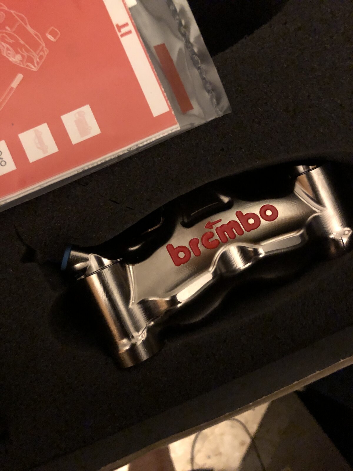

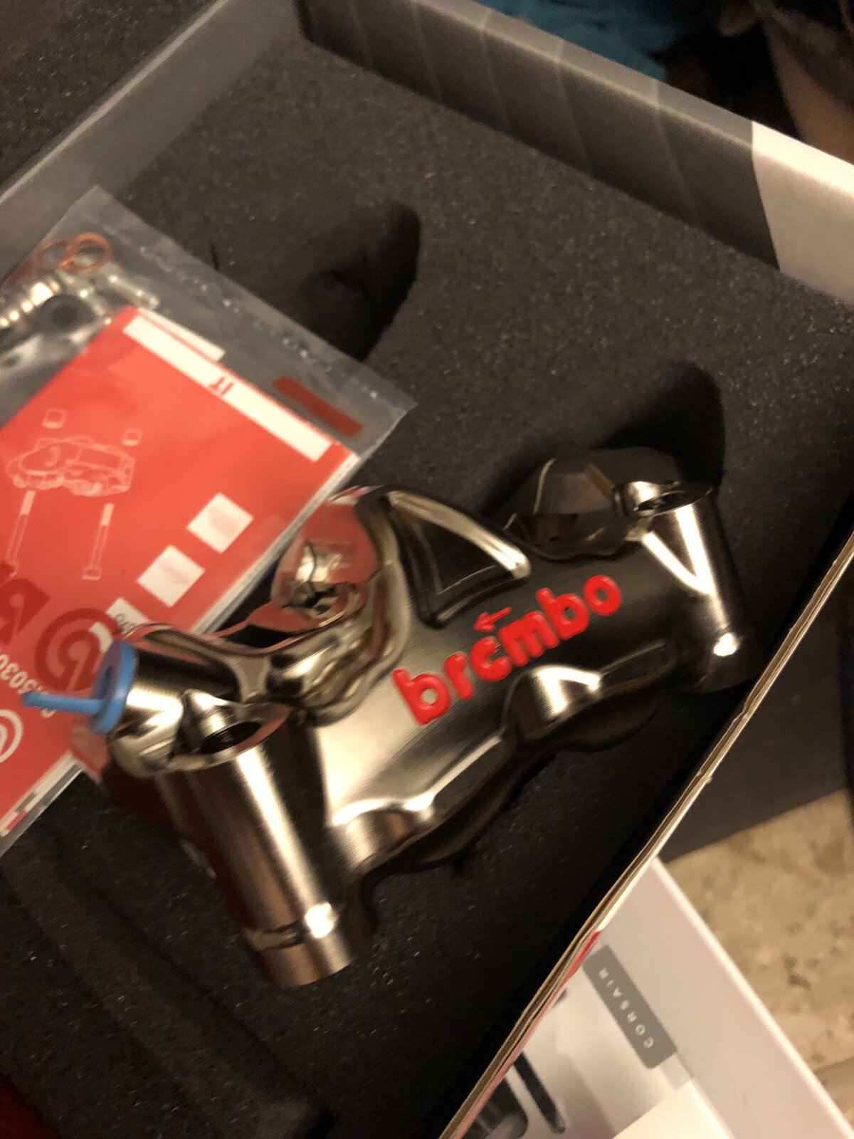

  18. Ok so I just got gp4rx brakes it’s made from one piece of aluminum mate, that makes it stiffer its the lowest level of the real brake upgrade. So as to say its track ready dissipates heat no fade, it’s the real brakes minimum you need. To be real chaps. The other shet is cast, it’s shet so I have to put them on, I want an upgraded Brembo corse Corta rr master cylinder but one piece at a time the brakes are shet!!! I agree….you have to be careful not to buy fake brembos!!! Ugh I will post new gp4rx front brake upgrade…*sic actually here is a pic in the box

  20. It’s 100 mm the distance for 959 I have to work out if I need spacers….I will post a pic of the bike….full race akro…upgraded Hopkins bla bla bla when I get them on boys kk
