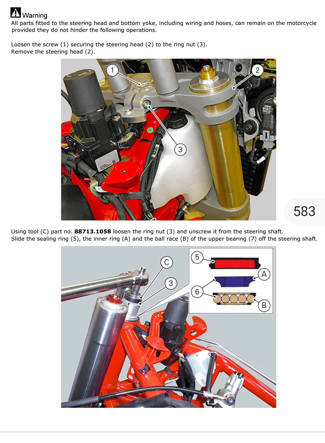

So assuming for a moment it's steering head, I could probably undo bolt 3 on top diagram in pic and nip up (i.e. make sure it's snug) the funny bolt with holes (1 in diagram) without undoing anything else I think? I know it needs looking at properly but I'm off to the ABR festival early doors tomorrow ... Note: I did have both forks out and top yoke off a month ago.
So nipped to the bike shop for a 2 minute once over, couldn't see anything wrong. Rode up and down a few curbs on the way back, no clonk there. Couple of little clonks on small potholes on the way back. Might just be bodywork but I feel a bit better about it now having had another pair of eyes on it.
Might be worth running around the bike (not literally... Unless you want a challenge) just pulling and tugging at parts to see if something is physically loose rather than visually.
Thanks yeah, I've banged it, pulled it, poked it and wobbled it, can't find anything wrong. No play in the head I can feel (pulling and pushing at bottom of forks) all appears fine ... it may just be in my head and there's nothing wrong at all ... It'll be due the Desmo service fairly soon, won't attempt that myself, so I'll get them (whoever I take it to) to take a look the head bearings etc then. Appreciate the input.
