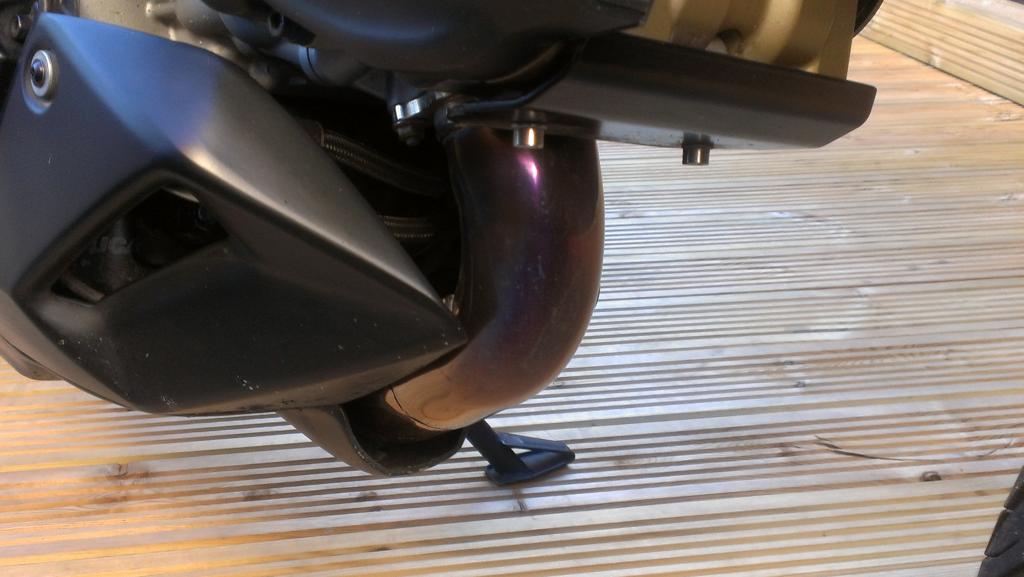

  1. Could this be the start of something to worry about ?
    The bike is going in for its 7.5k service and I want the dealer to be made aware of anything that could be potentionally expensive to me when the warranty runs out in oct.
    It has a full termi fitted and the previous owner polish all pipes and i cleaned them up after my Alps trip a month ago, it was after this the change in colour happened

  2. I would think that's just natural heat discolouration.

  5. its running lean and running way to hot, did you remap the fueling after changing pipes???
  6. It's completely normal

  9. I agree here, i would get it checked/ mapped at the very least. a very weak mixture could also cause the exhaust valves to sink/burn if not attended to, then its an expensive fix.
    a dyno run for a checkup is around £30-£40 , well worth the peace of mind.

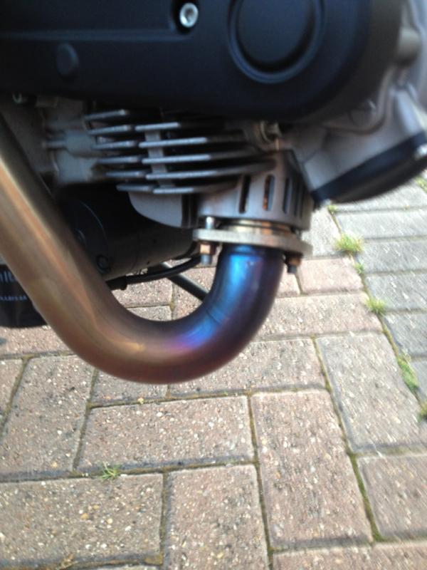

  16. My opinion, thats not normal. unless its had the nuts revved off it for an hour whilst stationary, thats piss weak. Only doom will follow.
  17. Well that's your opinion and your welcome to it , if you heat any stainless or titanium it will go blue .
    Now if it was glowing cherry red at night it has a fuelling issue . That picture is a 2012 monster that has done 1000 miles not had the nuts revved off it
