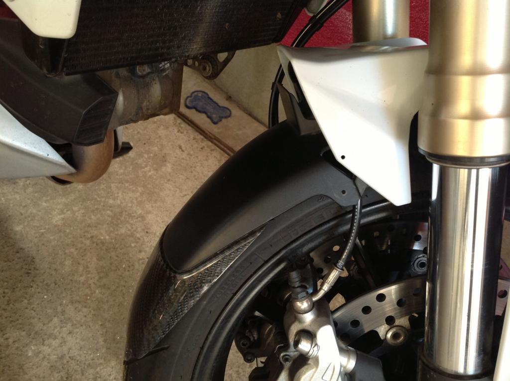

  2. Hi, I had the same problem. I put an extended front guard on in carbon glued to the short mudguard. To be honest its a crap original fit which doesn't as you say support the extra length, mine rubbed against the tyre too. I remedied it by drilling two small holes either side where the short mudguard fits to existing mudguard and securing with two small cable ties. I have removed the extended mudguard now as I am about to trade my multi in for another. I will take some pics to try to demonstrate how it worked. Vince

  4. image.jpg Hi, as promised a picture of front mudguard not in its fixed position. the holes that you can see were where i threaded a small white cable tie through.Basically you need to fix the mudguard in place using the two allen screws then lift the front an back of the m guard upwards before drilling the hole. Insert the cable tie x two, when they are secured there will be a gap between m guard and tyre.This sort of fix may not be to your taste but it works! Vince
