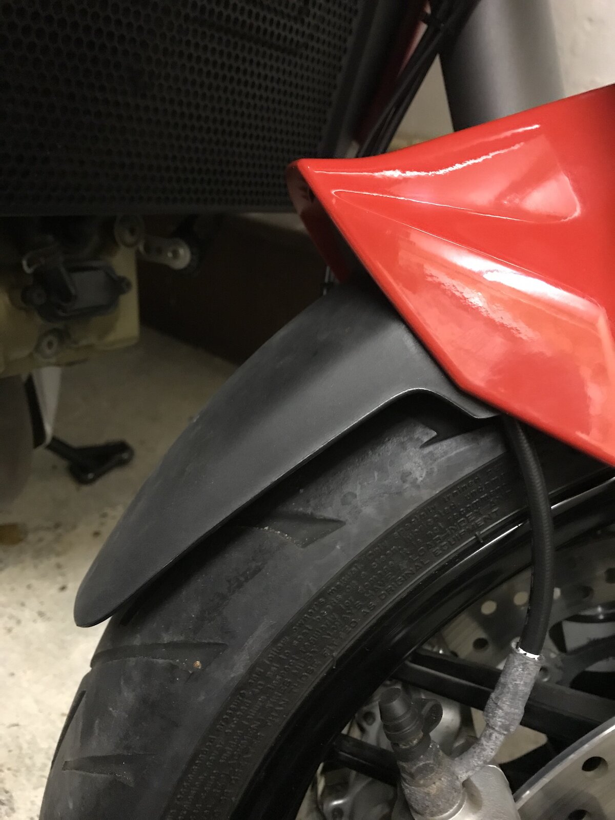

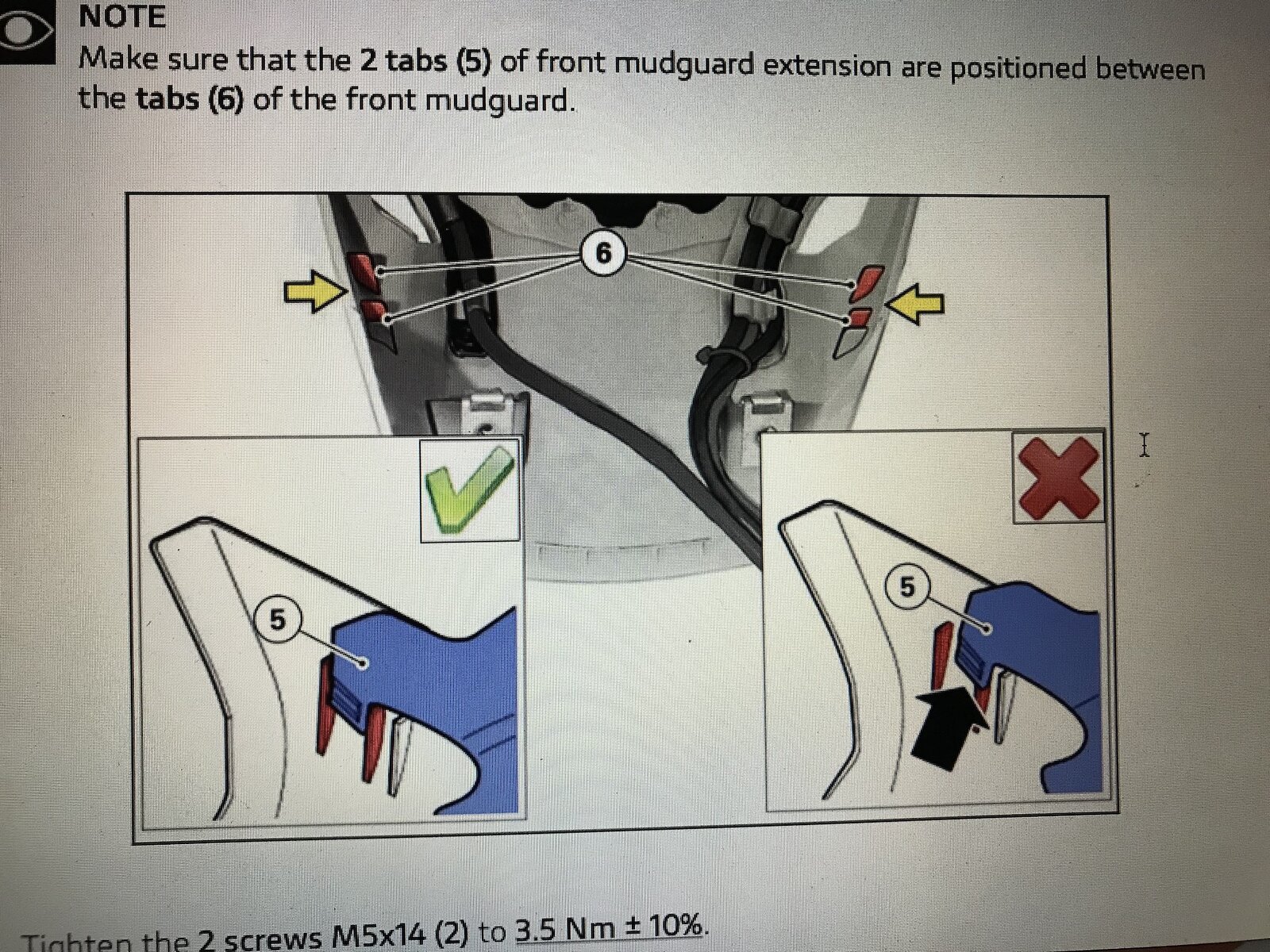

  1. F89E520C-AE76-40F2-85C3-BE330D4D94F6.jpeg So I purchased the Ducati front mudguard extension (which I believe was supplied with bikes when new but not fitted?) Mine didn’t come with one when I bought it so ordered and fitted today as per Ducati Service bulletin (SRV-SRB-19-027) but it fouls the tyre? Am I going wrong somewhere? Tyre is a Scorpion Trail II 120/70/17. Aren’t they the OE tyre?
    #1 Ackers, Feb 20, 2020

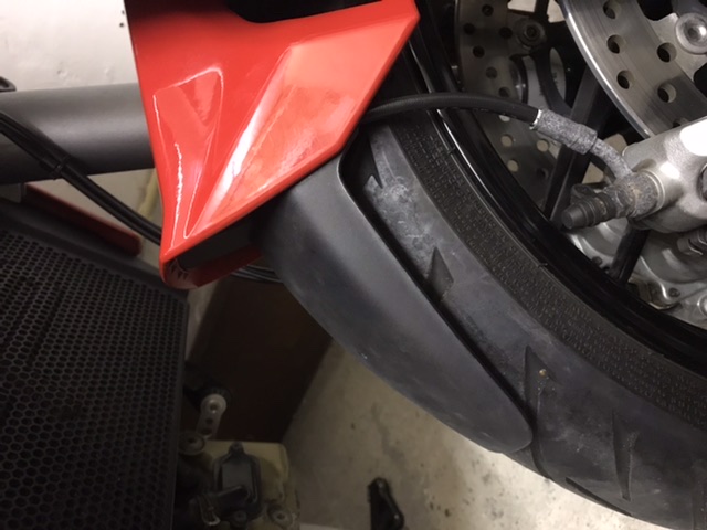

  2. That cannot be fitted correctly. I can get my hand between my tyre and that mudguard extension on my DVT. Two mins and I will add some photos
  3. Here ya go - mine even has a flap on the bottom too and there is loads of room. Its a brand new tyre too, so it as high as they go

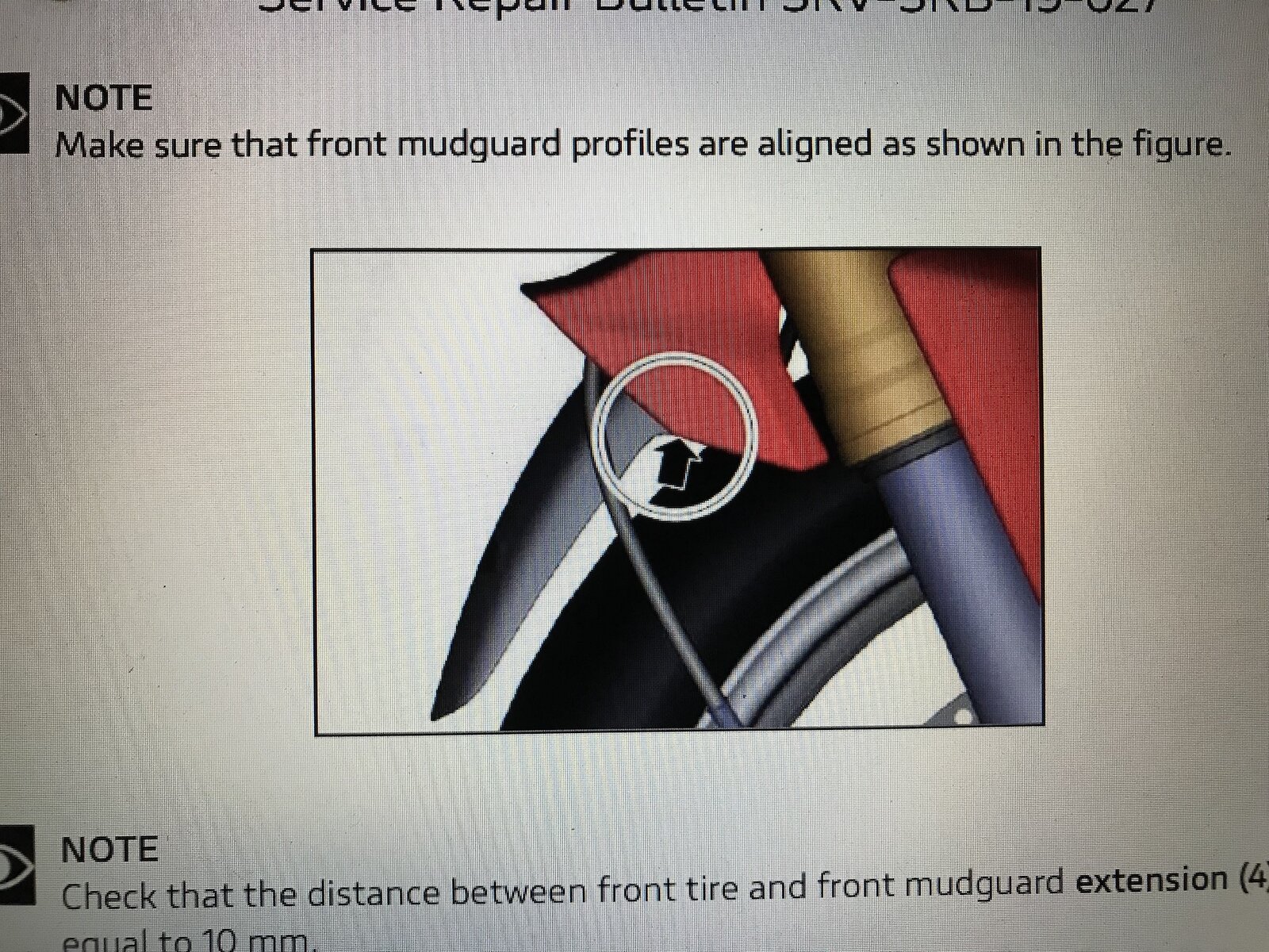

  4. Cheers for that. If I fit mine like yours its ok (see pic) but if you look at the page from the bulletin its not actually fitted correctly?

  5. Mine was fitted when I got the bike, and I'd have to say it looks right enough ? You need space between the tyre and mudguard cos the tyre "grows" in use and will end up tearing that extension off otherwise.
  6. Dunno if it matters but the diagram has the brake line over the extension?
  7. Mine was the same when I picked it up. To the point where the plastic was rubbing through the brakeline and had started on the metal. Can't remember exactly what the issue was but probably the brake line routing. I would suggest taking the extender off and starting again.
  8. Yeah, I suspect those images are meant to be in X-Ray to show the hose routing, rather than a definitive afterview. Mine are underneath and the extender fits perfectly. Page 2/5 bottom right illustration seems to show that better ;)
