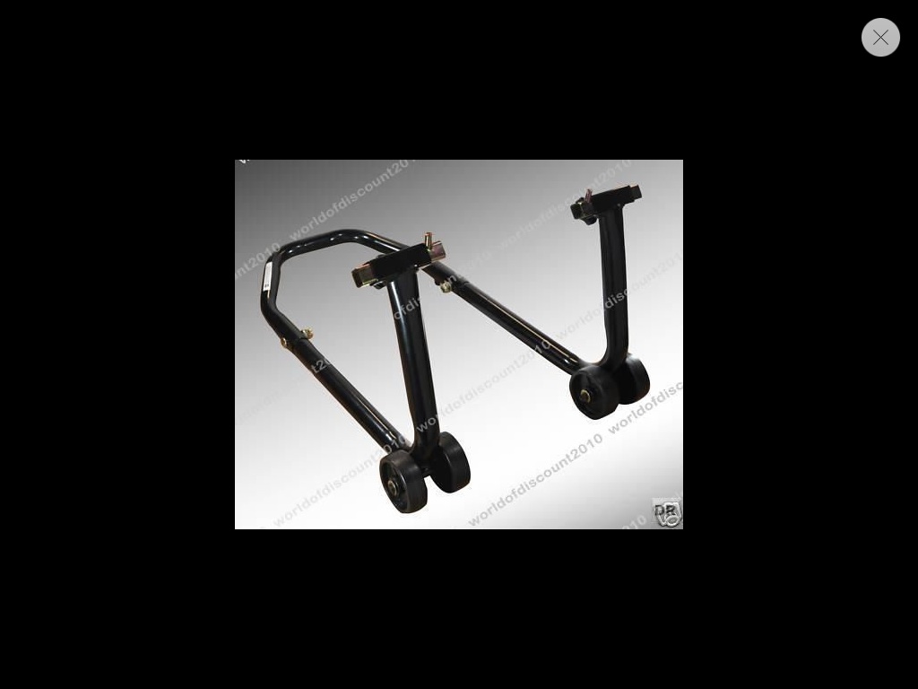

    I currently have one with pads like the below which I use on my R1, problem is the base of the Ohlins simply won't sit correctly on them and the pads keep slipping and folding back
    So which type are you guys using?

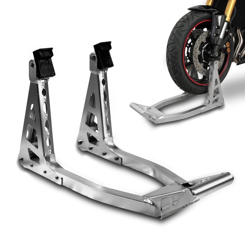

    The ones with the two prongs either side?
    Or the ones with one locating pin each side pointing upwards? I did run my finger under the bottom of the forks and couldn't feel a hole so guess the locating pin style don't work

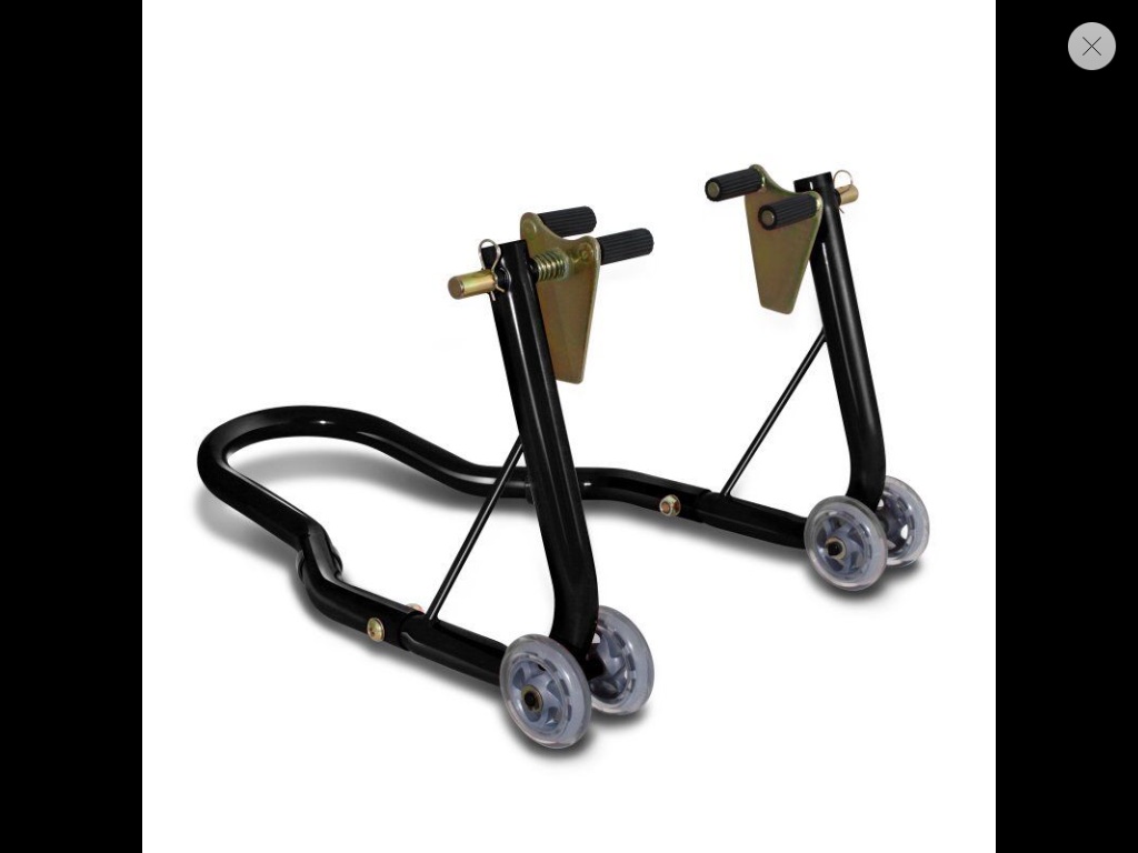

    Pin style -
    Or prong style?

  5. i use the first one in the original post you have to push under more as it was for first edition multi but took both wheels off this morning using it , just be careful works a treat
  6. most use the second type and put it under the caliper mounts rather than fork bottoms

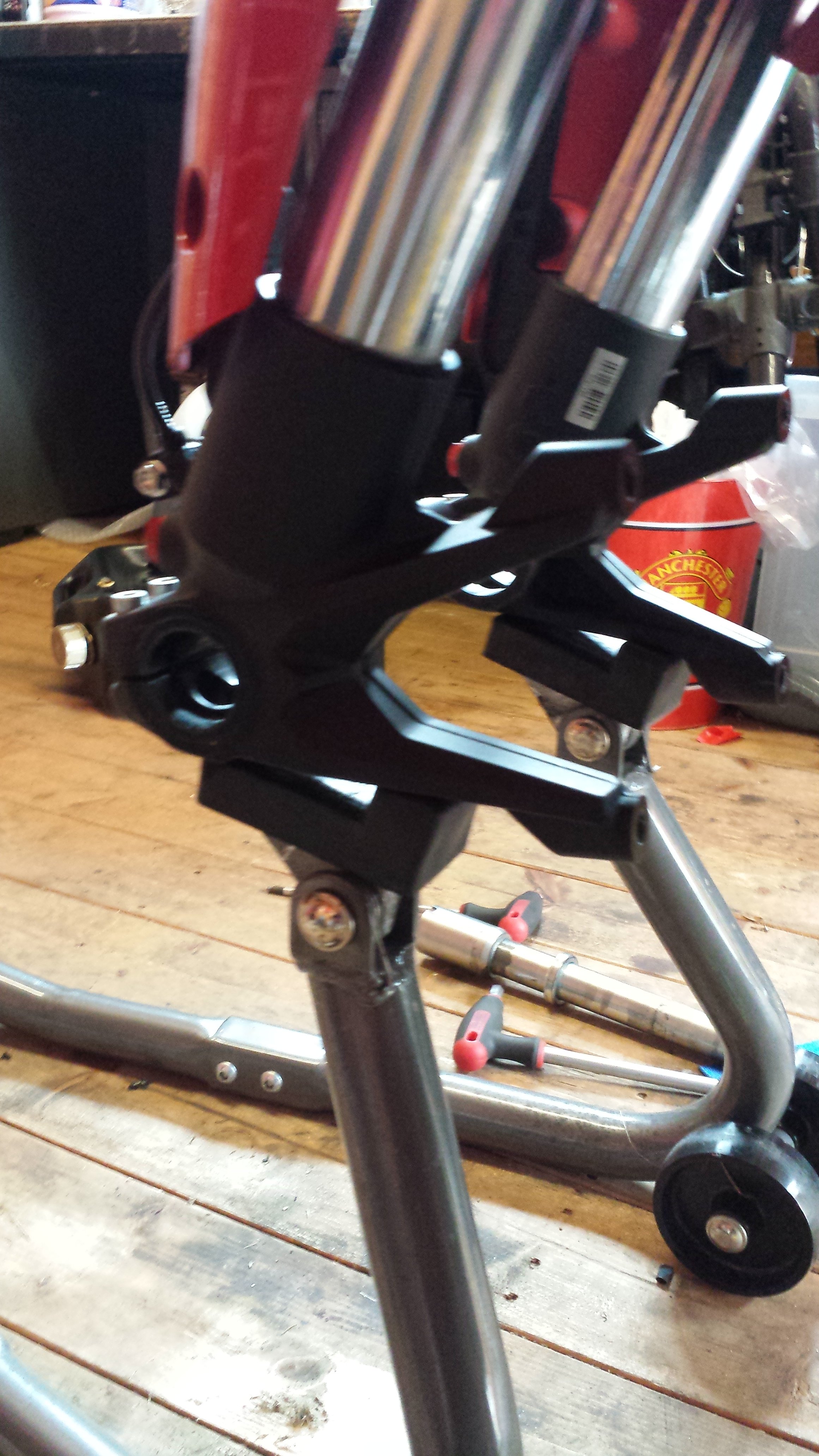

  15. I used the two prong type on my 2010 MTS, not used yet on the 2013 but I guess it would be same, I just put the pegs under the calipers as someone said earlier.
