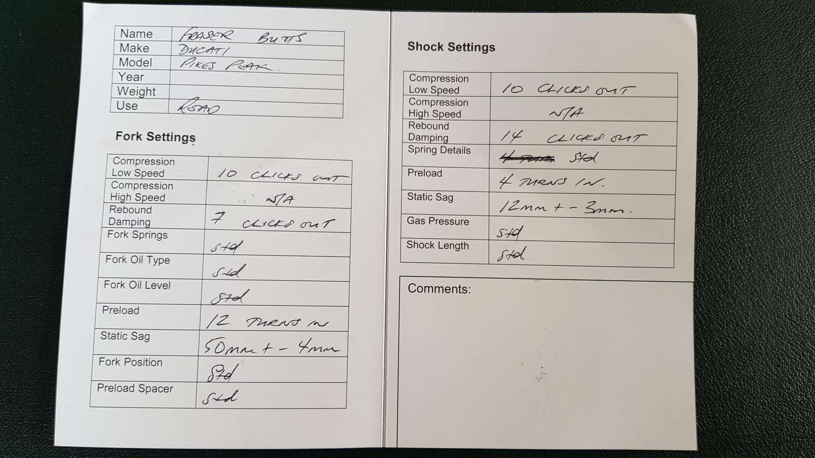

    Someone posted this a while back. I'm pretty sure it was for a 1260PP. I haven't tried it on mine, Reactive Suspension are only a couple of miles away from me and I've had great results from the basic ride in set up offer on previous bikes.
    Just need to get mine booked in!

  18. Sorry mistyped - meant to say more by luck than judgement with other settings and that's why I went through it all as attached with my preferred settings in red

  20. The front looks about right (two clicks stiffer than the standard Touring setting) but the rear looks wrong with the Rebound more clicks out that the Compression. Compression is normally a couple of more clicks out than Rebound.
