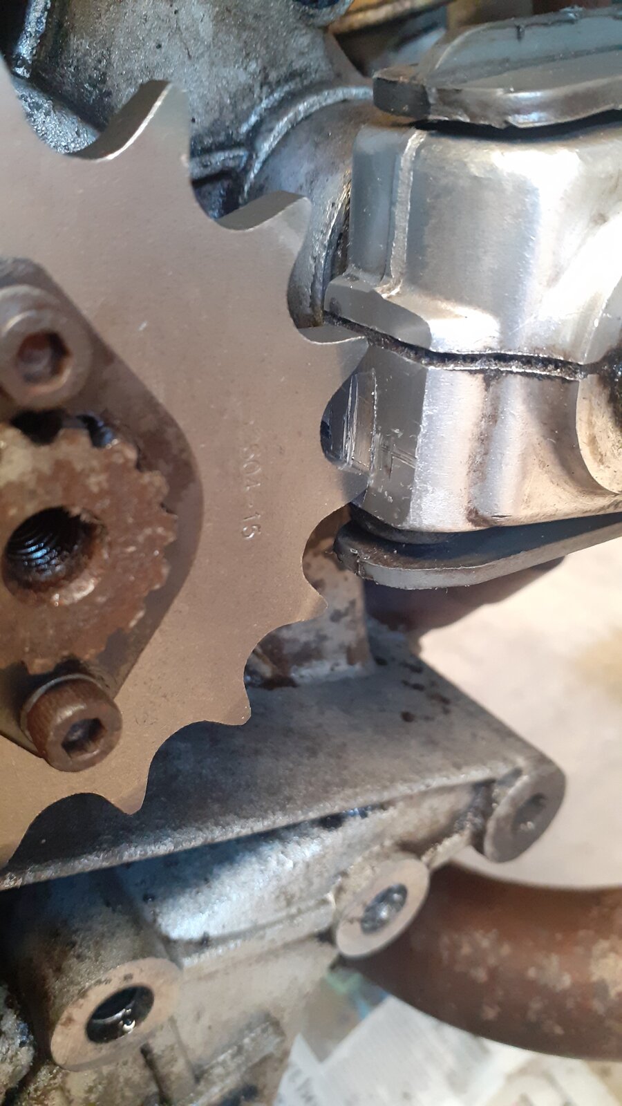

    Just got new sprockets and chain for my M900 '96.
    Just fitting the front sprocket and noticed the old sprocket has grinded out a groove in the swing arm (see photo). Has anyone else had this, or is there a problem with my swing arm...or worse!
  2. Has the rear suspension ride height been cranked up, pushing the swinging arm down (relative to the bike) so that the lower front edge is nearer to the sprocket?
  3. 15T sprocket - is that larger than standard? (I have no idea on these SS bikes)
  4. I've had the bike 11 years and I've never changed the suspension.
  5. 15t is standard at the front
  6. The chain will be a bigger diameter than the sprocket.
    Something is wrong.
  7. Chain doesn’t run on the back side of the sprocket…

  9. Aftermarket sprocket/incorrect spec front sprocket might have taller teeth than oem part so rubs . You need to compare to genuine item to check teeth height
  10. I’m surprised no-one has suggested looking for free play in the swing arm pivot bearings and pin. Wouldn’t be the first time swing arm bearings have worn. Andy

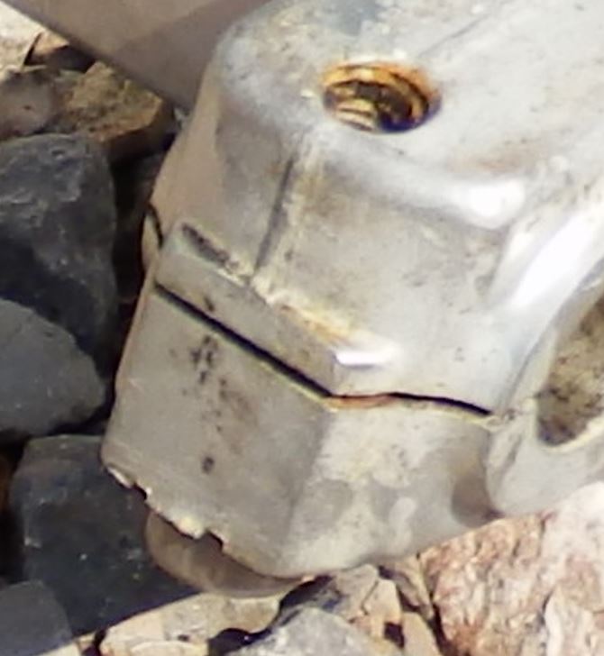

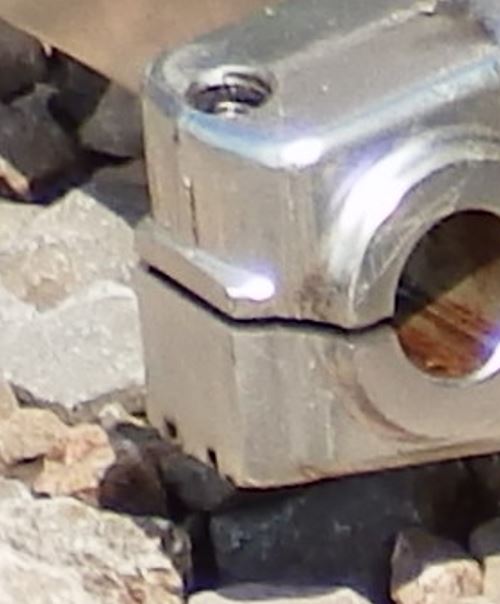

    I have a couple of M900 aluminium arms for sale at the moment and just blew up some images of them as I wanted to check the shape of the lugs where the sprue for the casting process was.
    The lug on the front of your arm does appear to be very slightly longer than either of the two I have:
  12. Exactly the same as the one that was on there. The other one is probably what did this.
  13. My next move.
  14. Yep, yours look about 2-3mm shorter, which would make a massive difference!
