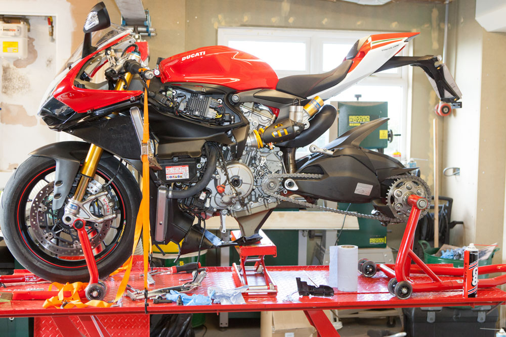

  5. Sorted it out this way: IMG_3177_1.jpg
    I know it's wrong to support the sump this way so I gradually wound the jack by hand until the rear paddock stand began 'floating', the rear stand is just stopping the arm from dropping now.

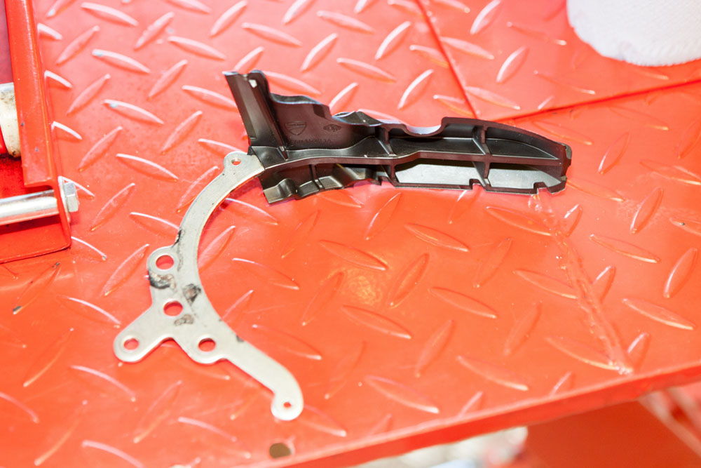

    There was no way I was going to clean all the crap from the front sprocket area without removing the left foot plate. Here's the toughest part to clean:
    I kid you not, it took over 1/2 hr of scrubbing with toothbrush, GT85, chain cleaner and airline to get it to this stage. It was full of road chippings encased in chain lube... At least I know how to do it next year:Cigar:
