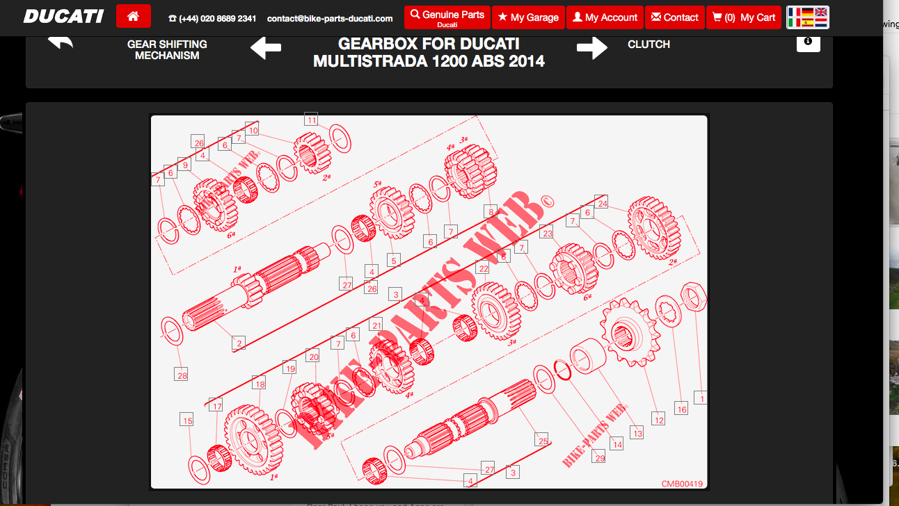

    Anyway, once I got over the efficiency with which @Gerr removed the FS I checked and sure enough, 2014 MTS Standard w/ABS has the boss facing outwards :):upyeah:
    Part 12 in the attached drag
