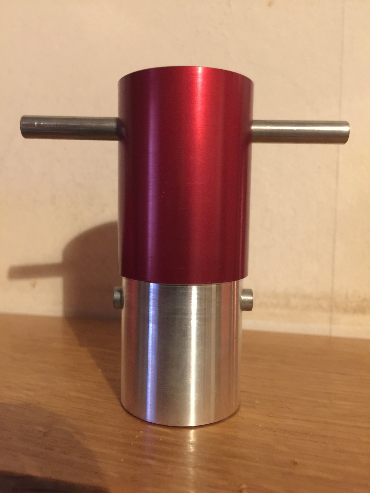

If its stuck, I sometimes use the tool for setting the front axle (tube with two lugs) and use mallet to tap thru as a drift
@bradders I haven’t got an alignment tool and I’ve searched the garage for something the right diameter to act as drift but can’t find anything. Just wondered if there was some everyday household item that I hadn’t thought off

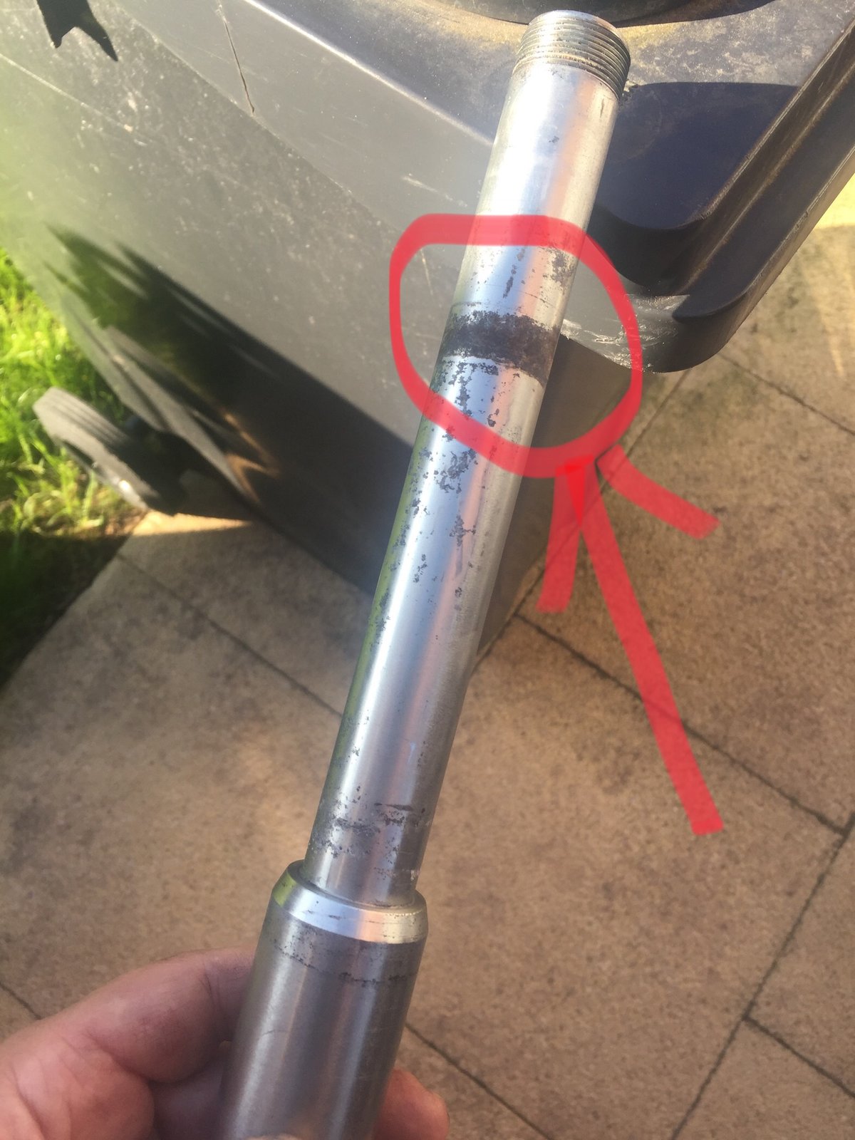

A word of warning, be very careful using a drift as you can splay out the spindle. How do I know this because I have done it! One of the spacers was seized onto the shaft as when I had my front tyre replaced the tyre fitter didn't grease the spindle. I ended up having to replace the spindle with one off eBay.
All pinch bolts removed. The shaft just wont move, I suspect that I have the spacer seized to the shaft issue. Liberal coatings of WD40 or the like?

Good news!! A night of a good soaking in WD40 and a sharp couple of taps this morning with a “real” mallet and 1/2” socket on an extender has removed the shaft. No damage done to the shaft end luckily, and a bit of corrosion on the shaft from the spacer . Certainly very little grease on the shaft from the last time it was removed by the dealer. As the photo shows the left spacer had seized onto the shaft. So thanks @Desperado for the heads up, spot on! Thanks for the advice everyone, much appreciated
