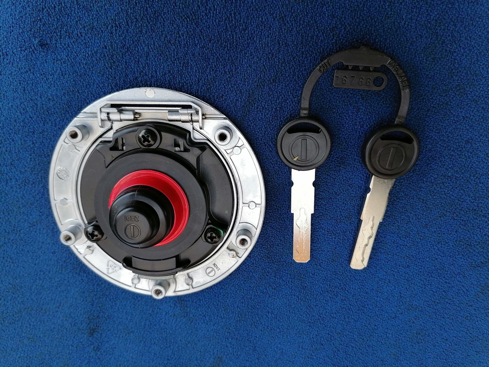

  1. Are they the same? I bought one and it doesn’t fit and before I complain I want to make sure they are the same..
  2. Pretty sure they’re all the same from the 899 to the 1299. At least they all fit each other
  3. The race cap I bought has the bolts around the outer side, 5 I think. The 1299 has inner side, sure there were 4. Anyone with an 1199 able to tell me for sure if it’s inner/outer bolts and if 4 or 5
  4. The fuel caps on the 899, 959, 1199, 1299, V2 are all interchangeable, they have 5 screws around the outside, the inner plastic part is attached to the tank by four screws.
  5. I’ve worked it out. I’m guessing it’s because they do a keyless option…but wtf are they doing having the cap in two pieces?! This has to be the most infuriating bike built. Ever. Period.
