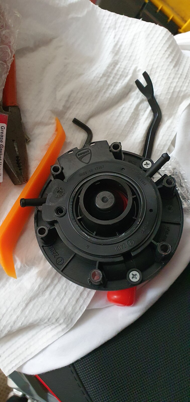

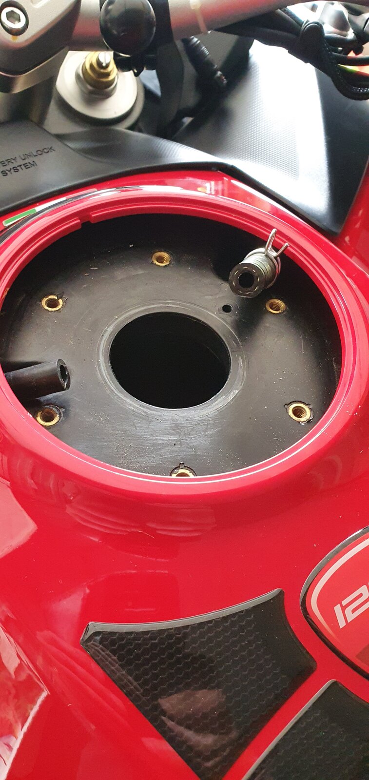

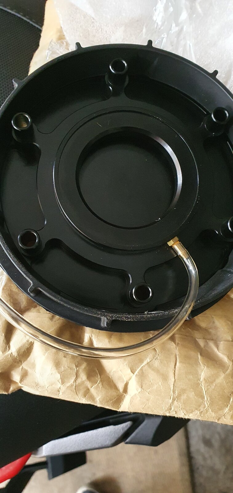

  1. Hi got this screw cap to fit to my 1260 multistrada. Now theres 2 pipes which connect to the original cap but on new 1 theres only 1.now 1 will be over flow and 1 a breather.
    So question is which do I blank off and which do I fit new breather pipe to 20200704_131022.jpg 20200704_131014.jpg 20200704_130946.jpg

    If that’s the case, you could remove one pipe altogether or blank it off. They both look to be a similar bore so working out where each pipe terminates might help you chose.

  5. IIRC the one on the right is the overflow and the left breather, think the overflow terminates at the emission/evap pot on the lhs behind the rad! Breather possibly terminates there too!

    You can fit the new cap without removing the tank cover .there is a rubber seal which compress onto of the tank to seal cap and tank.the rubber infill around the cap is awkward but cover it in rubber lube and a slow hand it goes in

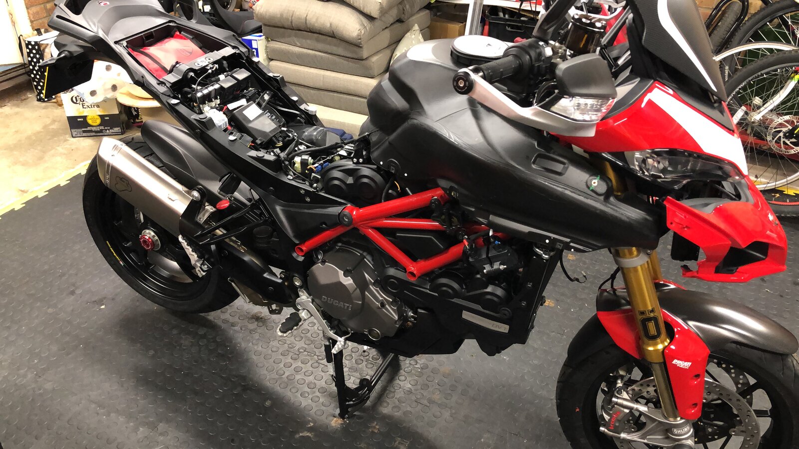

  12. Correct, if sat on the bike, the RH nipple is for overflow and the LH is breather. If you do the evap delete mod, you'll need to get a new overflow pipe as it's too short.
    You need to remove the black air intake covers (2 bolts either side under the key cap, then slide back to remove), then the 2 side panels, seat and at this point, you'll be able to access all tank fairing screws.
