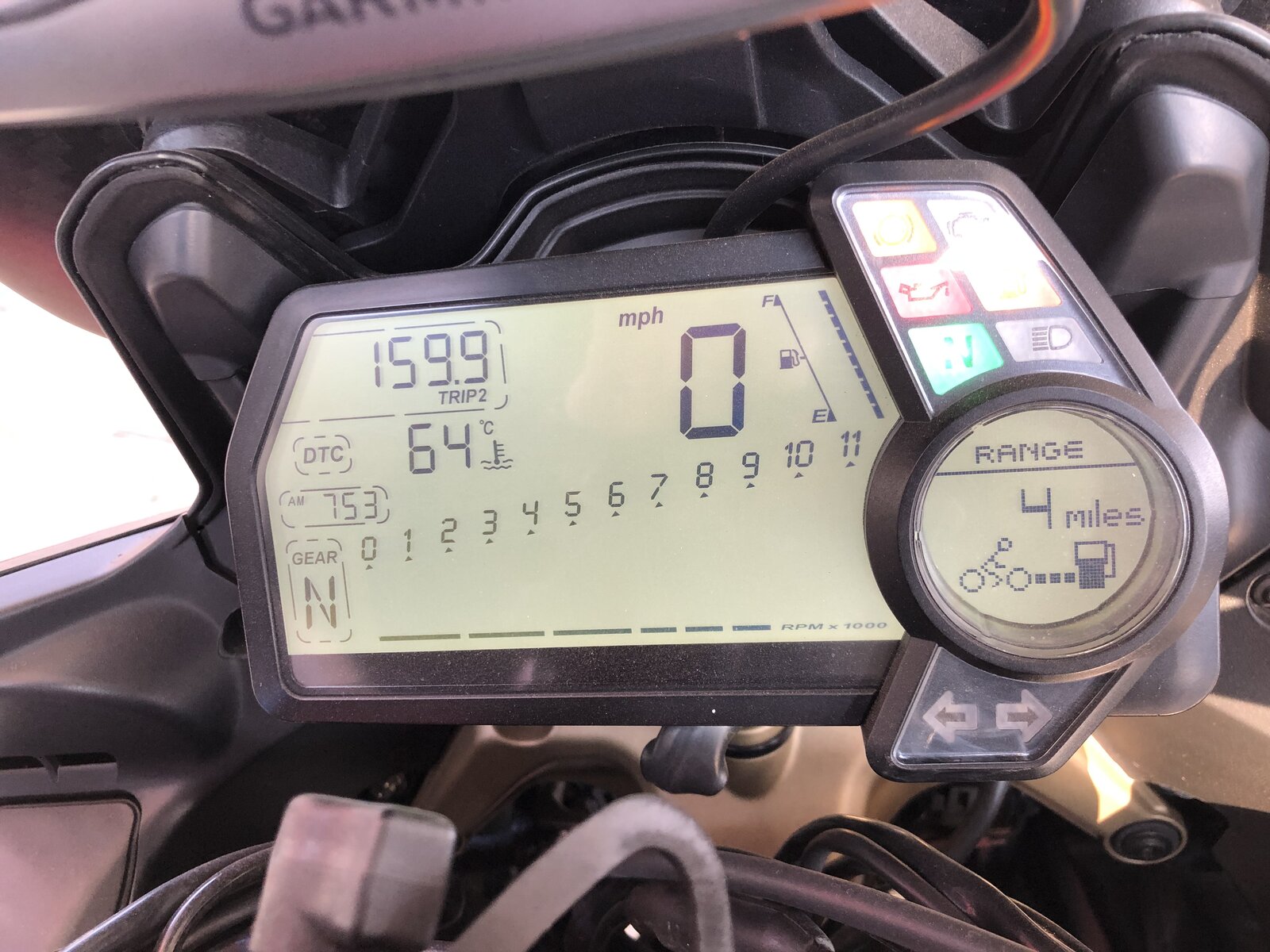

  10. So after posting this I finally got through a tankish.
    Took this photo this morning at a petrol station. Are we saying this is about right? Or am I drinking fuel with this set up. The trip was reset after last fill up.
  11. What’s your siding style. On occasion I got down to 35mpg but that’s ragging it all day.
  12. I’d say average pace, I don’t hang about but not super quick. And amble sometimes.
  13. Is your fuel gauge accurate?
    have you tried old school maths to get a true mpg figure? Do some decent miles, starting with a full tank then refill at the end noting the miles covered. Easy then to work the mpg out
