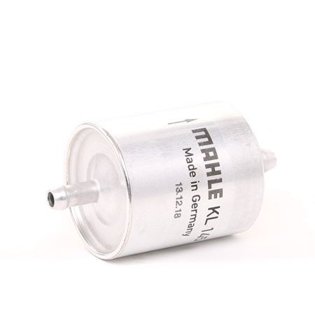

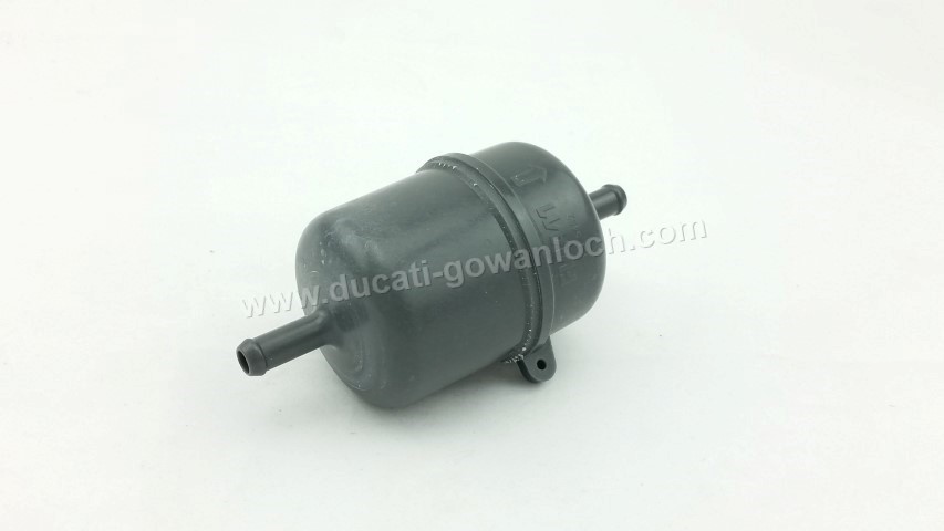

  1. i have a spare Mahle K145 fuel filter, can i use it in place of the smaller filter used in the 749/999 & Monster S2R . apart from being slighty bigger and in a metal case is there any reason why i shouldnt use it?
    if not, does anyone know of an aftermarket equivalent for the over priced Ducati item?
    cheer
  2. If you can fit it in use it. It's a quality filter. The rest is not really important.
  3. Would suspect that it is a BMW K series filter and should be just fine.
  4. Kl145 is used in the 9** range.
  5. The Mahle KL 145 is used in most fuel injected older Ducatis (desmoquattros) so should be fine, normally sold by Ducati dealers for lots of money with "Ducati" instead of Mahle

  8. Seems reasonable when you only change them every 18 years or so (as I did) :D I can't find the receipt for the one I bought but I'm sure it wasn't much, under a tenner I think

    Interesting point about lifetime filters. The fuel hasn't been on the service schedule for most Ducatis since the mid-2,000s.

  15. Cost aside, I'd stick with the correct filter for the pump. I've just this week sorted a 999 with a fuel pressure issue. That had the alloy 996 type filter fitted. The hard formed pipes on the 999 pump weren't sealing around the inlet/outlet spigots, despite having small jubilee clips done up tight. Fuel was leaking past the seal area. They're a slightly different size and the 996 uses rubber pipe.
