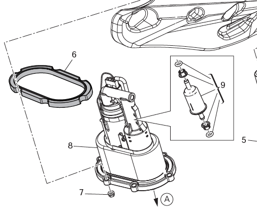

  3. There is a filter on the 2010 Multi. It's a Mahle KL97. To replace it you remove the flange with the pump, remove 2 self-tappers and slide up the cover over the filter. Extract the old filter, replace it with the new filter and refit the flange assembly.
  4. Cheers mate, will be doing that then soon, I asked a dealer and they said there wasn't one.
  5. Item 9. Part no.425.2.001.1A

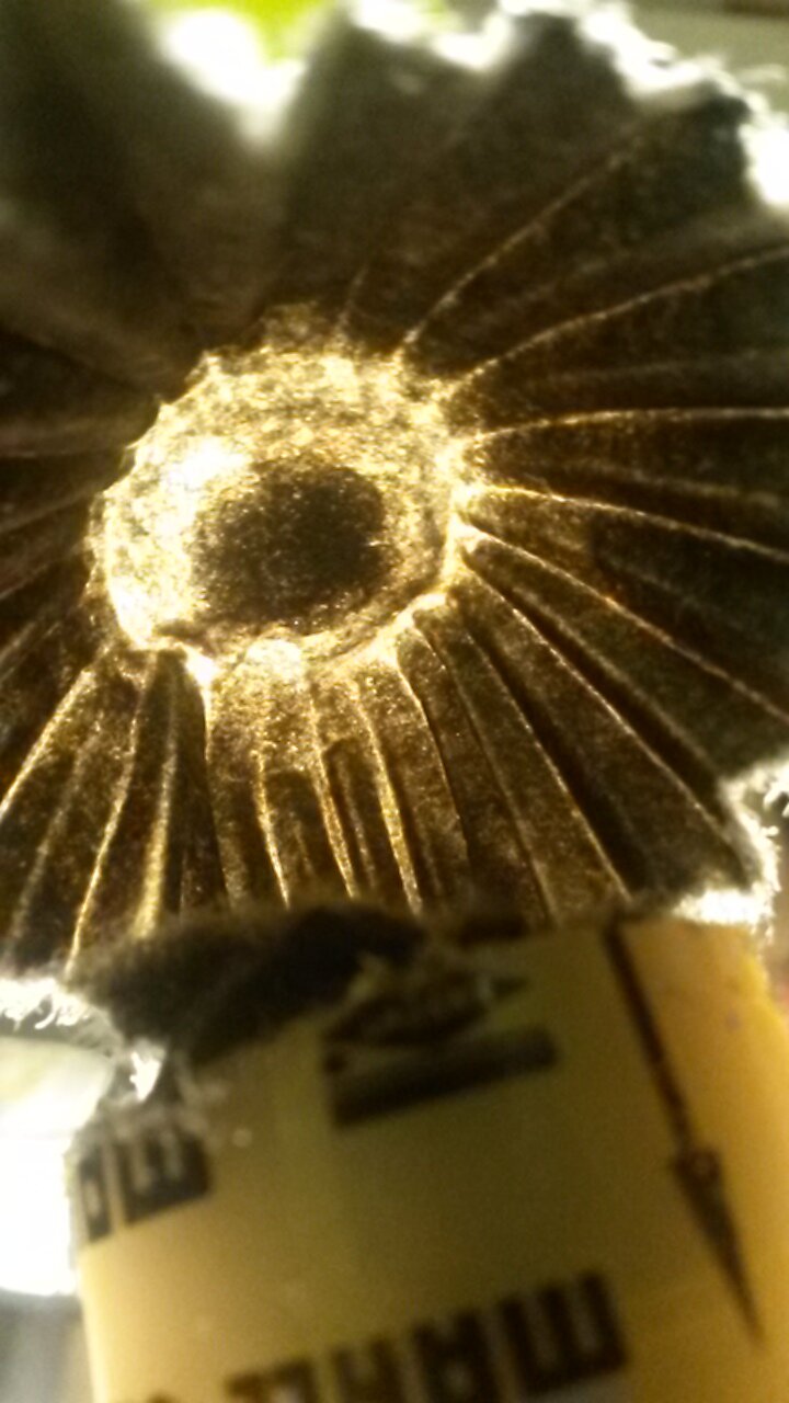

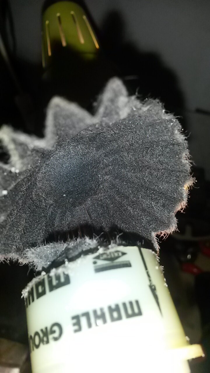

  9. MTS 1200 Filter 25000km
    20171113_132739.jpg 20171113_132807.jpg 20171113_132739.jpg 20171113_132807.jpg 20171113_132739.jpg 20171113_132807.jpg
  10. Ooo dirty, what fuel you using fellor? Diesel? That looks pretty bad, did it affect the performance of any other issues?
