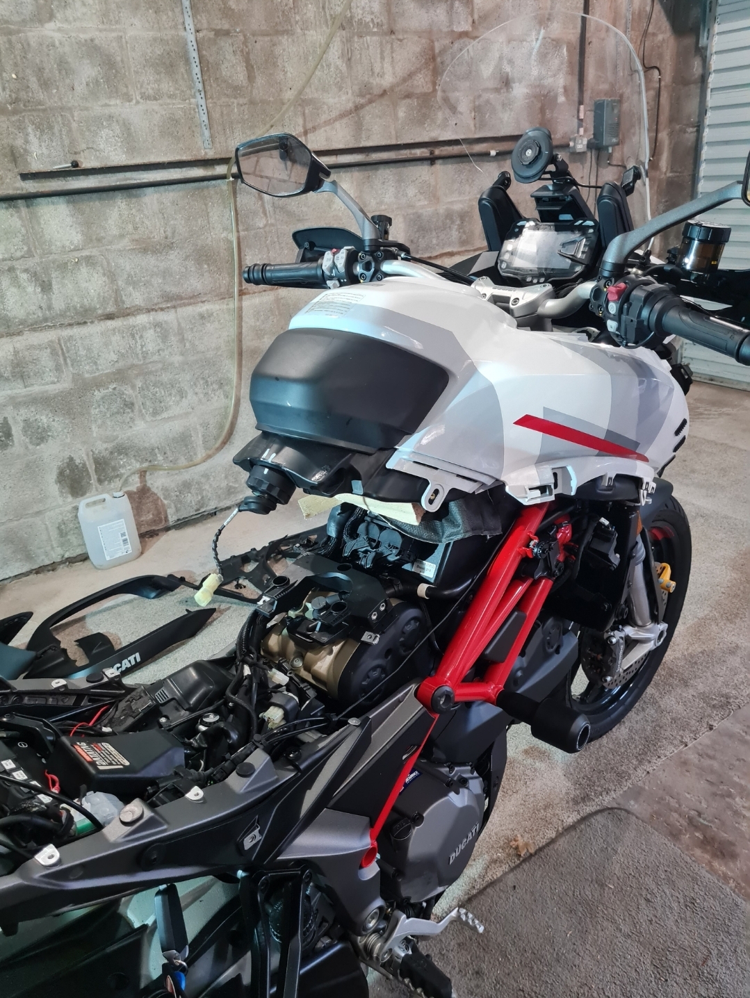

  6. Just done mine on a 2020 950s.
    Replaced the "F" prefixed part number with the latest "G" number.
    Fitting fairly straight forward, no need to remove tank and mess with plastic pipes at the front, just raised the rear enough to remove it . Screenshot_20240418_133855_Gallery.jpg
