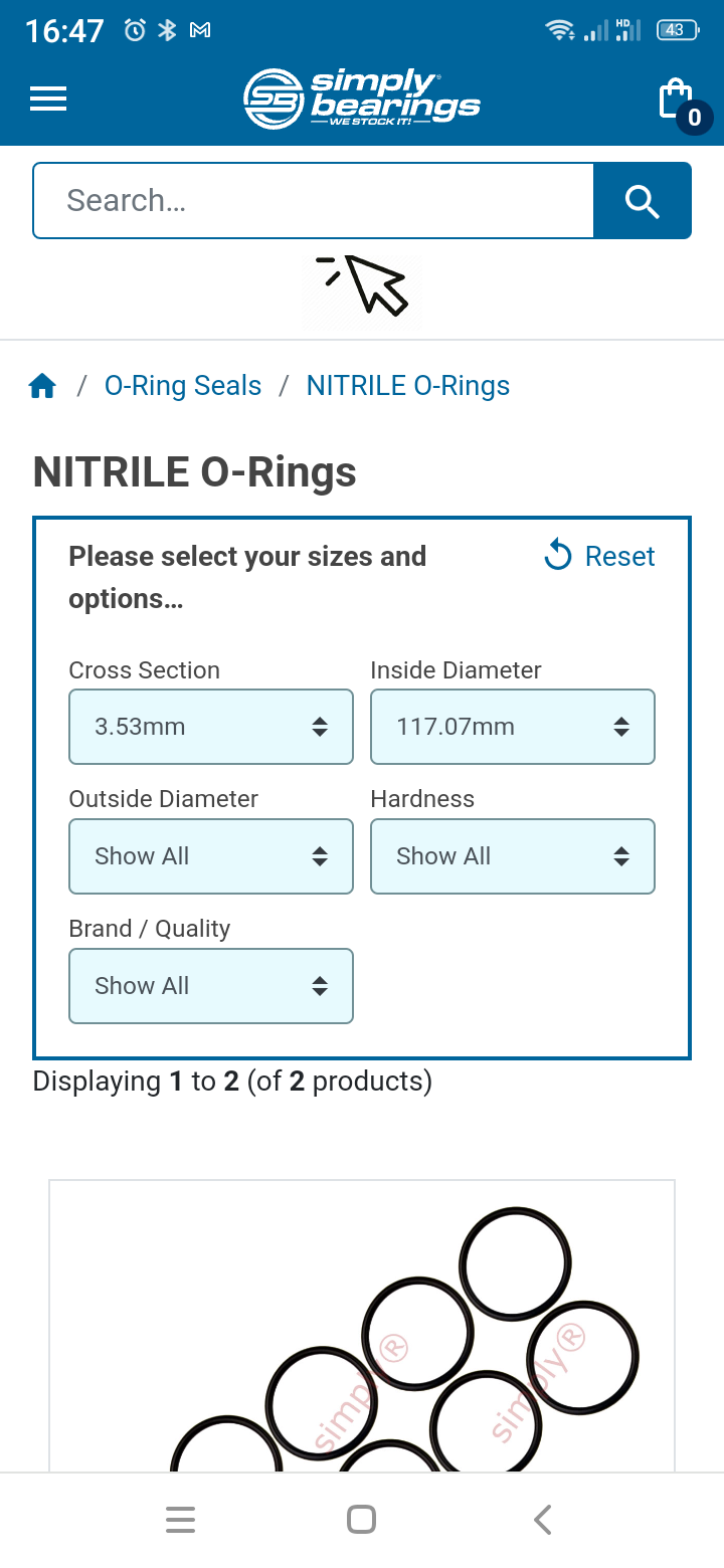

  6. Don't buy them from Ducati.
    This is the size. It doesn't have to be Viton either. Nitrile is perfectly save for fuel.
    Simply bearings sell them. £8 for 10 in Nitrile or £23 for 10 in Viton
    • O ring 117.07mm ID x 3.53mm
