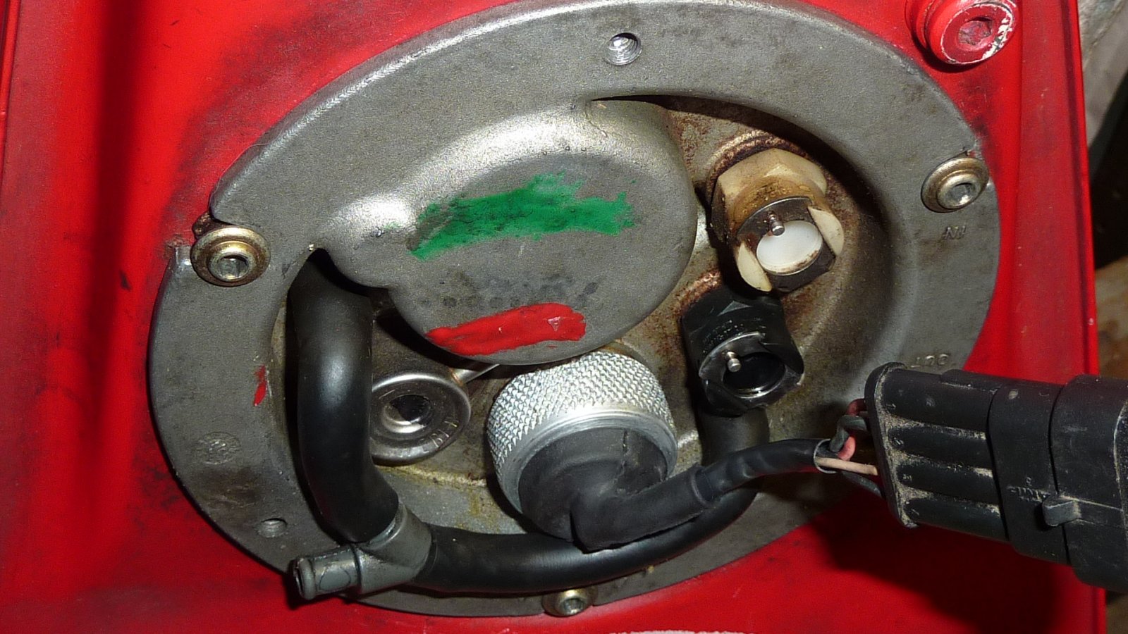

  19. Are they different to the 748 ? This is a pic of mine and the chrome clip slides and can get stuck so it doesn't click back in. fuel sender 001.JPG
    Steve

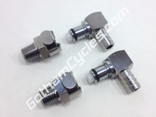

  20. If only they were like that Birdie it would be so much easier to modify them . I have been going to see if it would be possible to cut them off and tap the base plate to accept a threaded one like this picture . Maybe over xmas hols .
