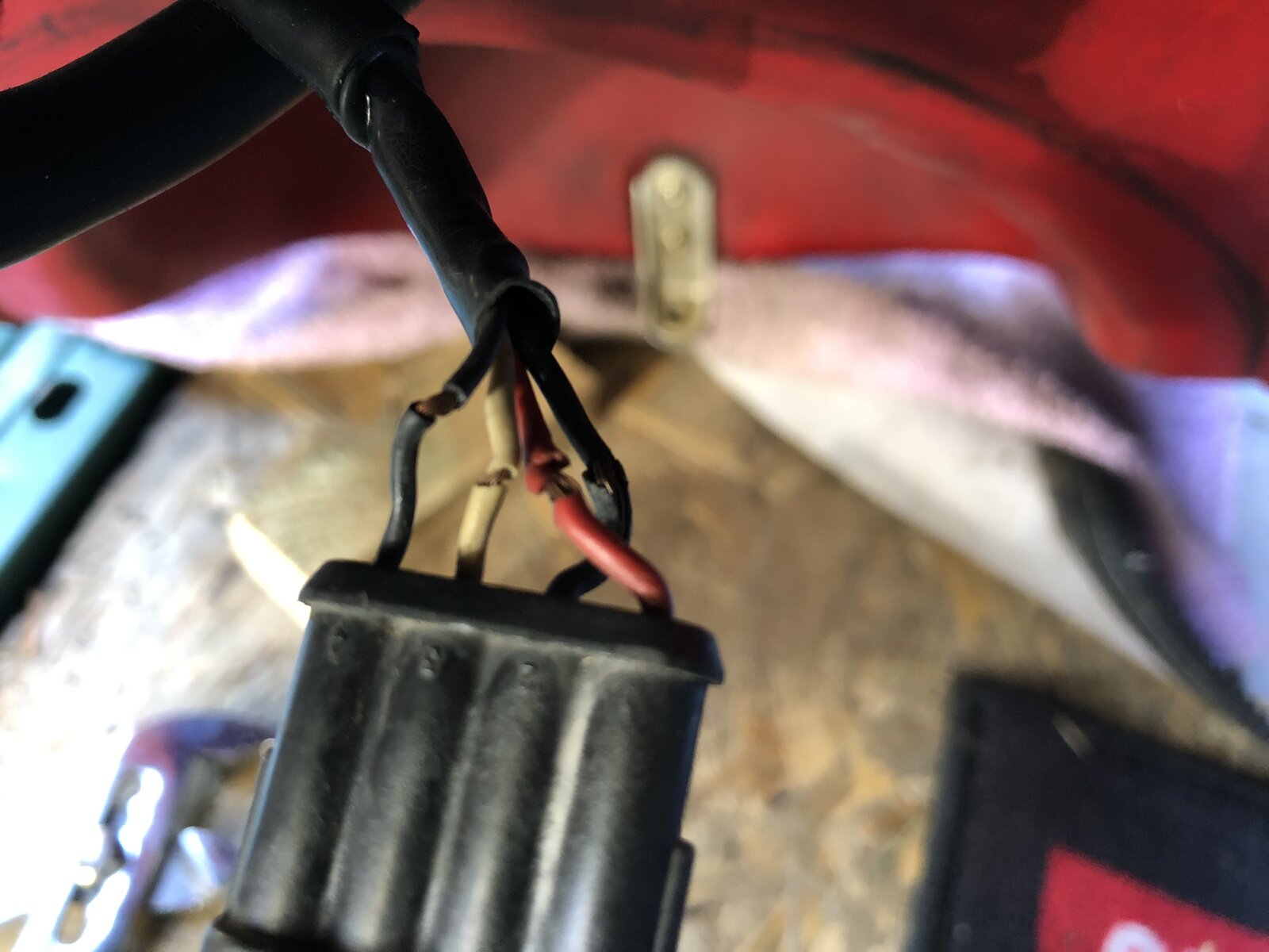

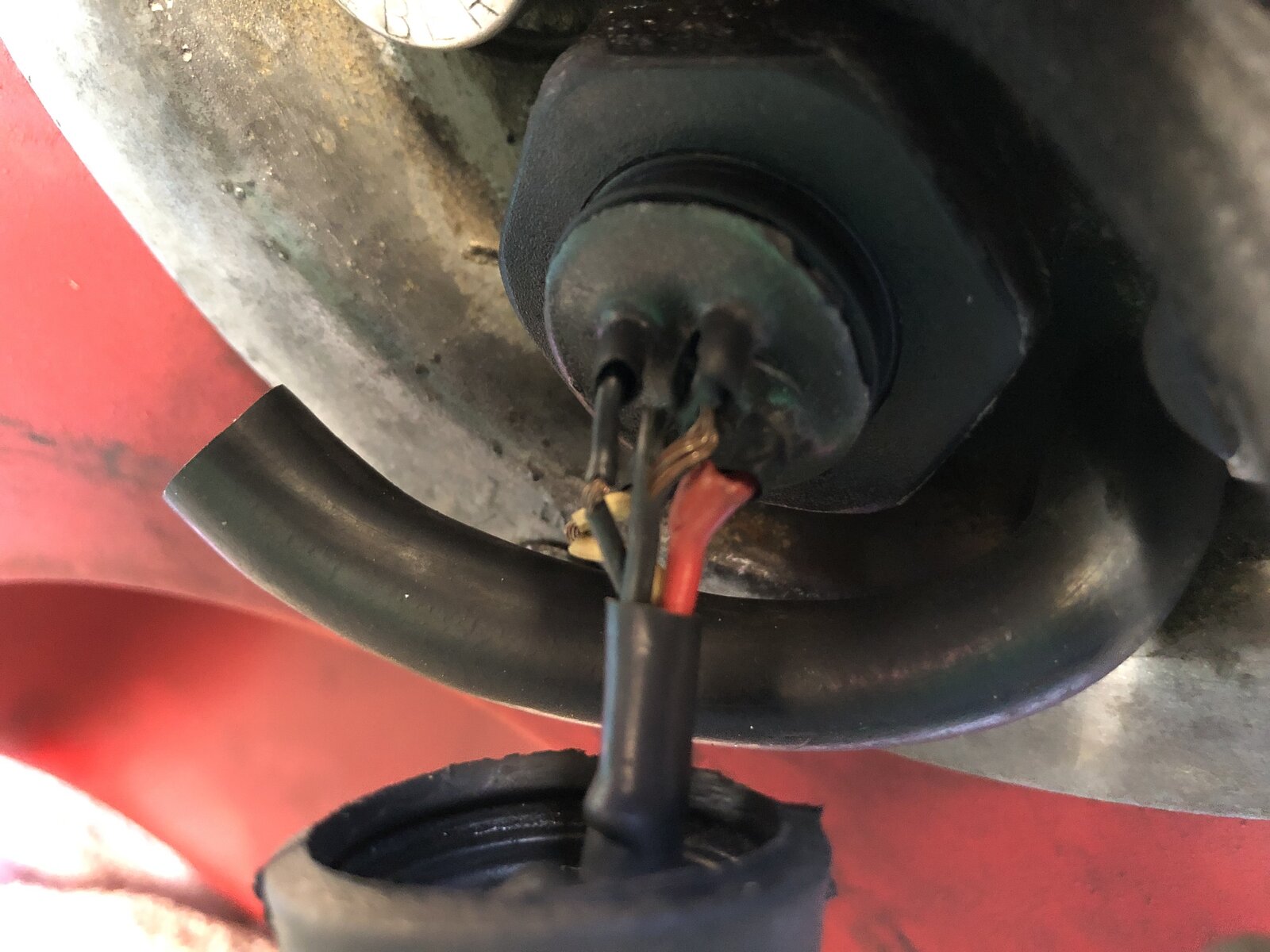

  1. The 998 arrived last week, and I’m not taxing it until July, so it’s been in my new Asgard shed. But I had to investigate the stink of petrol, lifted the tank to find a) the drain hoses weren’t connected and b) the leak was from the fuel sender. I know that the nut can crack and wondered whether there was a better replacement. (Ducati only supply the entire unit at c. £140)
    Also, when ‘investigating’, I found that the sender wiring insulation was cracked, exposing the copper cores!
    Presumably I can disconnect the pins from the plug and slip over some shrink wrap? C488AD94-2883-41E0-9DD3-7AD01CC25911.jpeg

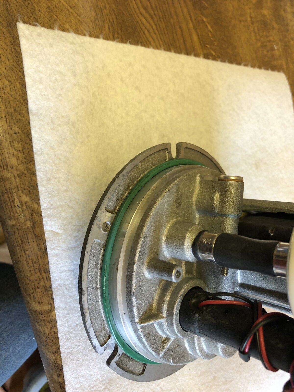

  13. Started the fuel pump refresh today by pulling the pump unit. I am right, no? The pump O-ring goes IN the recess, not at the top under the flange?
  14. …and the plastic QR fittings are b.. tight. Any clues how to extract them to replace with metal ones?
  15. In the recess.
