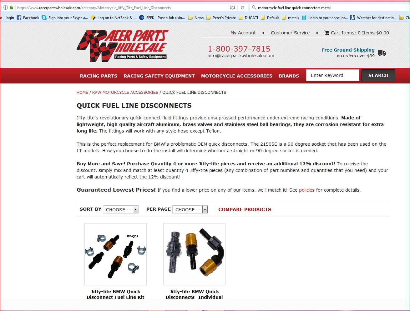

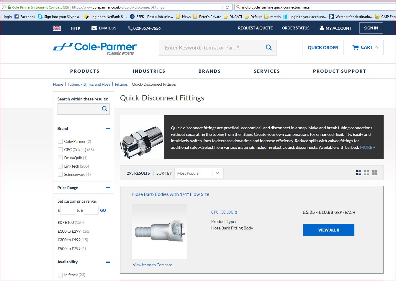

  12. need Orings to be viton or nitrile? need to be rated for petrol, work (seal) at low pressures , be smaller than air fittings, and metal??sliding plate lock, rather than ball bearing locK, (too big)
    Any of these, but only resellers, not manufacturers
    #12 breakout998, Oct 4, 2017
