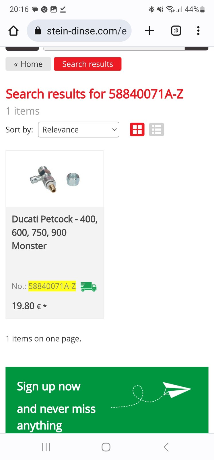

  4. I can confirm, this is not the same, having fitted them to tanks before
  5. Cheap enough from Stein Dinse though. Worth ordering other parts if required as postage from Stein Dinse Germany is high

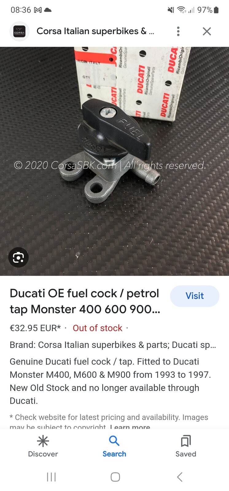

  16. There is a horizontal outlet on the tank which is threaded on the right hand side as you sit on the bike which faces to the left
  17. That would only work if there was some kind of adapter bolted onto the tank to create a way of then having a fuel pipe to that style of tap
  18. yes, that's the one I remember, other than that I can only recall a simple threaded outlet that possibly went to one or two inline filters at the back/under the tank. i.e. - later versions of the Monster dispensed with an on/off fuel tap altogether.
