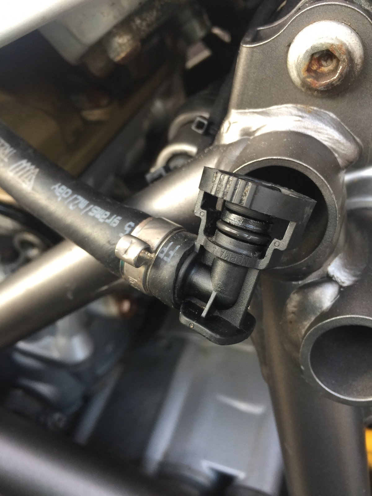

  1. Can't seem to get this off? The metal hose clamp?
  2. I had a couple like that on the 999 recently for the cooling pipes, stuck a flat head in and twisted. Had to replace with a normal jubilee clip.
  3. Well got the old Dremel out and cut the top, and replaced with a normal one lol
  4. Didn't wanna risk piercing the hose lol especially as it's kept in the house
  5. Called an ear clamp, more efficient than a jubilee clip, just cut the ear with some spring side cutters.
  6. These clamps are often referred to as Oetiker clips, they can be fitted and removed using a special tool quite easily. Removal will destroy the clip and a new one will therefore be needed.
