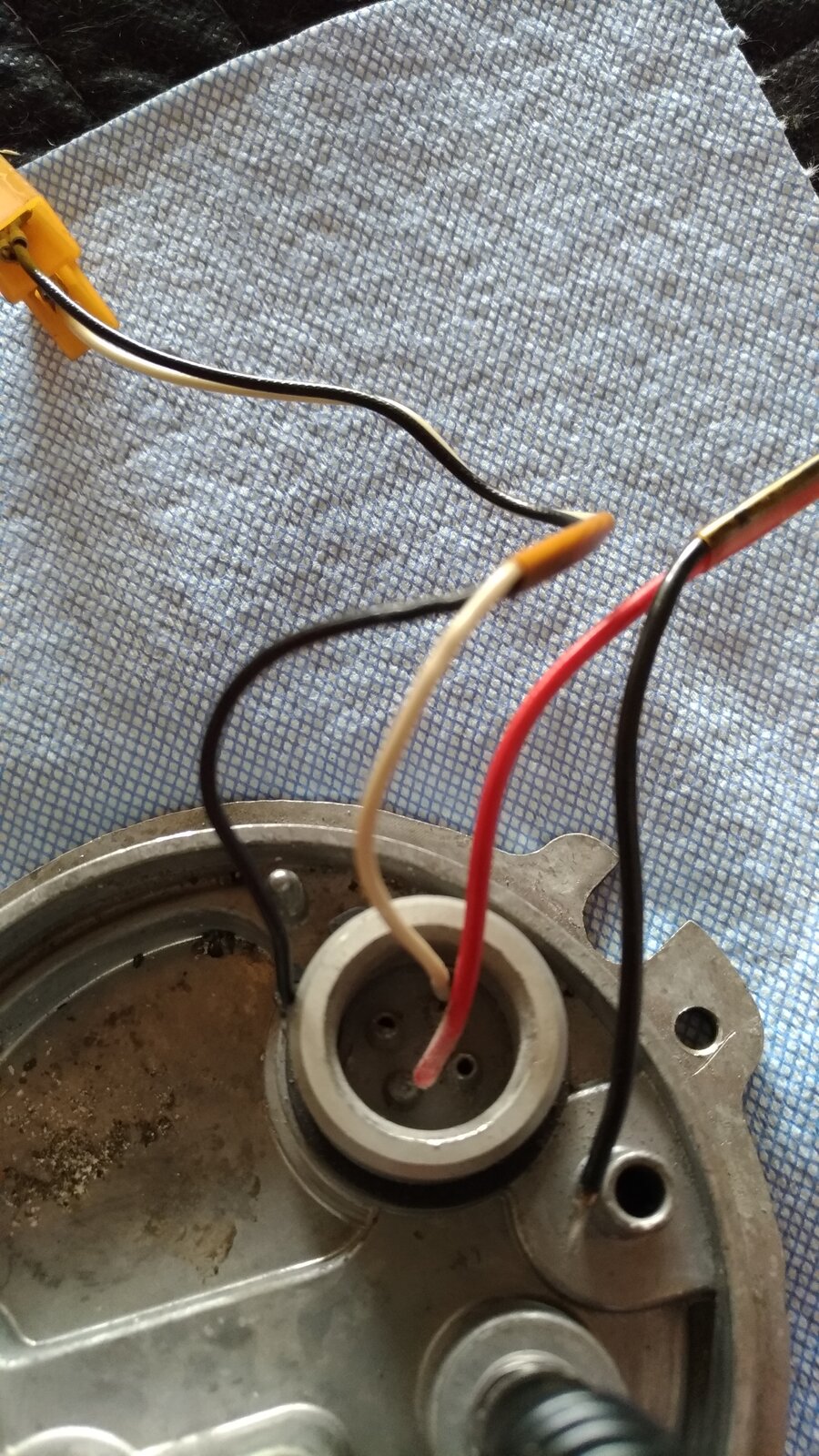

  3. The fuel pump relay is a 2 quid part, so start with that. A PIA to get at, though, in the battery box.

    I have seen wiring and pumps sold individually are these just ways to rebuild instead of buying the whole pump assembly units?.
  5. There are posts on the forum where fuel pumps have been rebuilt with commercially available kits. There are also posts on how to repair the wires into the pump. Are you able to get the pump out and bench test it?

  8. In the YouTube video, I didn't hear the fuel pump prime. Could be the relay, but most likely the wiring in the bulkhead through the tank. I fixed this last summer on my bike. The two black wires didn't appear to have ever been soldered.
