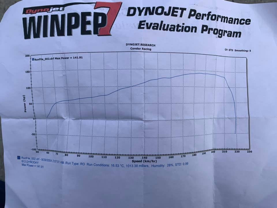

    You have now rekindled my interest in installing a left-over Rapidbike unit onto my stock 1260.
    This would tell us how much improvement comes from only the map change thus the remainder would be from the plumbing.
    One this note BTW, I really like your editing skills. Can you do anything with this chart (RPM and SAE) and overlay it onto your other 1200 chart?
    It's my mates stock 2017 1200DVT exhaust but with the addition of a Rapidbike unit.

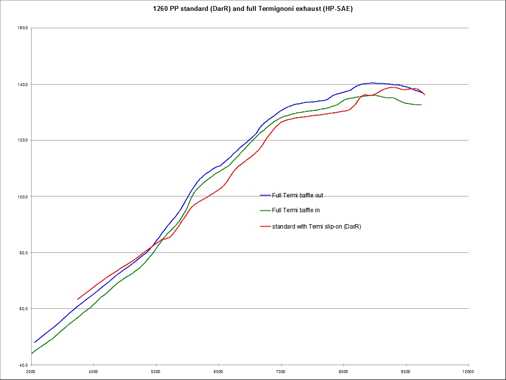

  5. Although this is a superimposition, your chart is revealing. @Duncan* and feel free to step-in anytime to discuss your methodology. It seems the Termi with Upmap adds power over stock, (baffled and un-baffled) up the mid-range. The Termi, baffled and un-baffled detracts power at the lower end (i.e below 5000), and at the top-end (above 8500) when baffled.

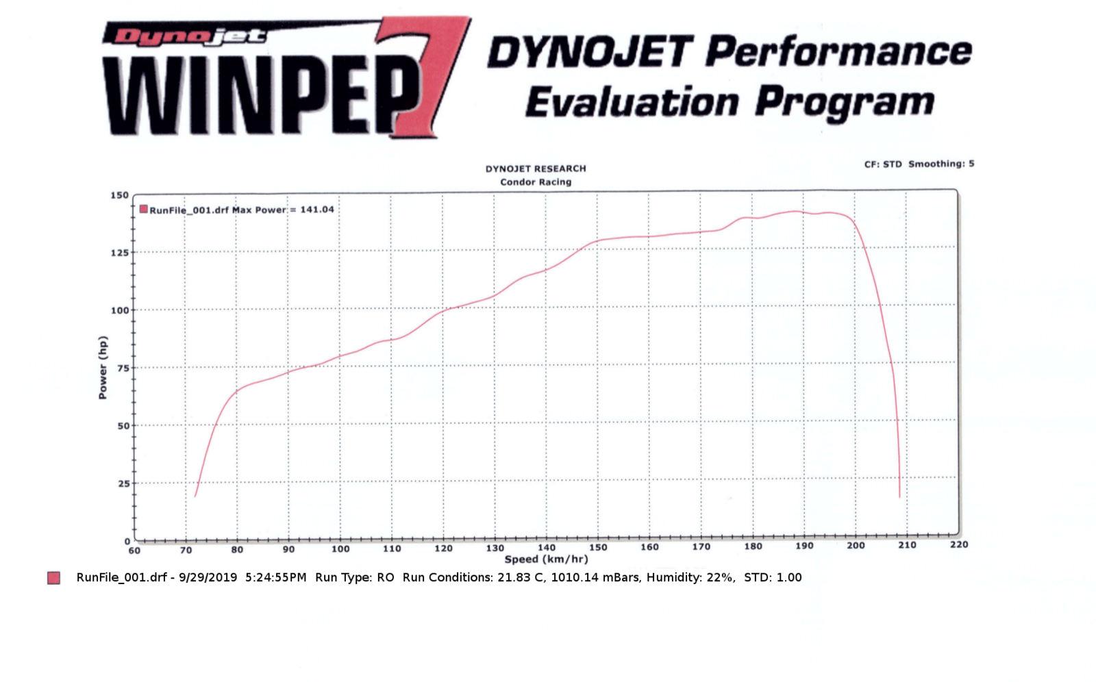

    My Dyno chart (Stock 2018 Multistrada 1260 PP)

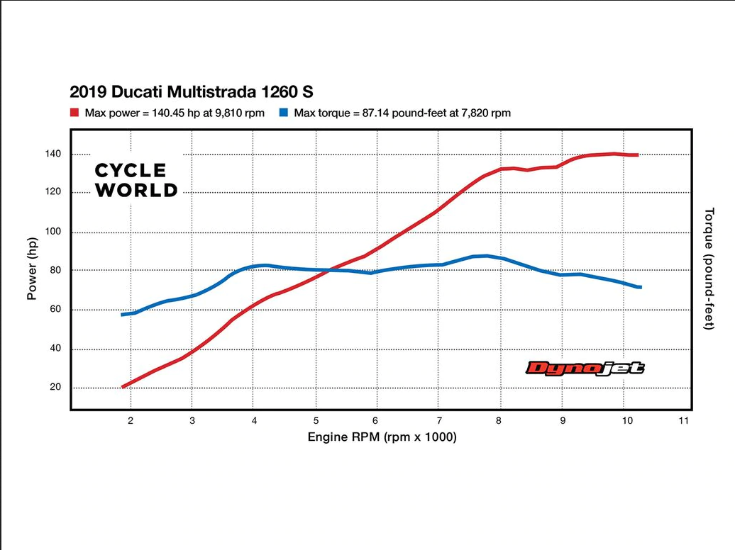

  10. I did not provide torque figures. Consequently you may want to use this Cycle World torque curve for a stock 1260 for consistency.
    In fact it may be clearer to use both the HP and the Torque from this chart which has the RPM's on the X axis.
    Moreover, those torque curves cannot possibly be taken from a dyno at the rear wheel as they are way too high.
    Do you have your actual "Full Termi" dyno sheet for torque?

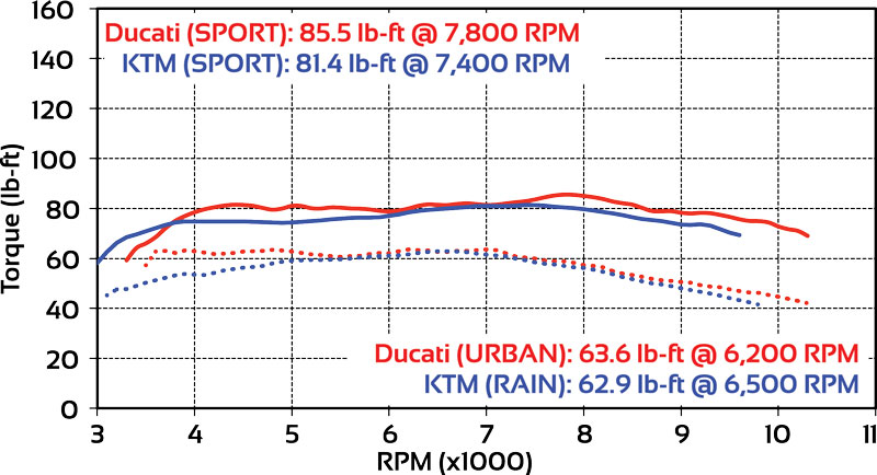

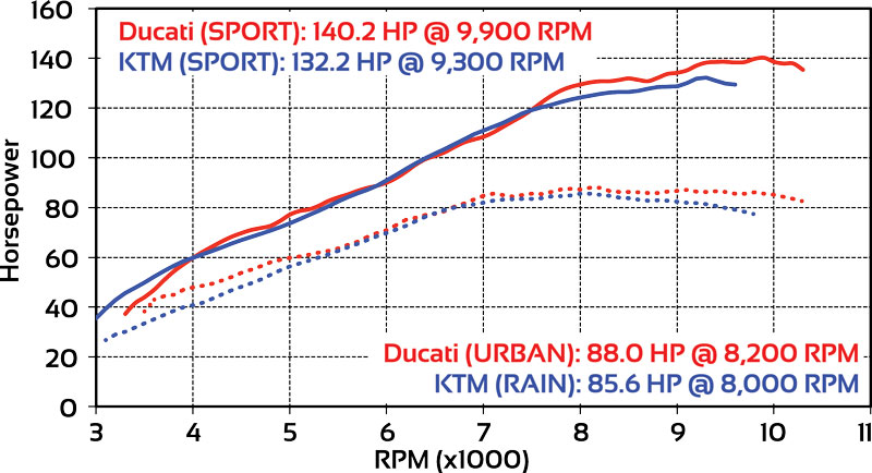

  12. Hi Duncan, there's no way that a stock 1260 can generate (on a rear wheel dyno) 130 Nm @ 7000 rpm as shown on your chart. That's about 96 ft-lbs.
    I would use the torque curve from Cycle World above (even when converted to Nm) which is congruent to this one from ridermagazine.com below:
    As you can see, it's nearly identical to the Cycle World torque curve. Peak torque occurs at 7800 rpm on both charts.
